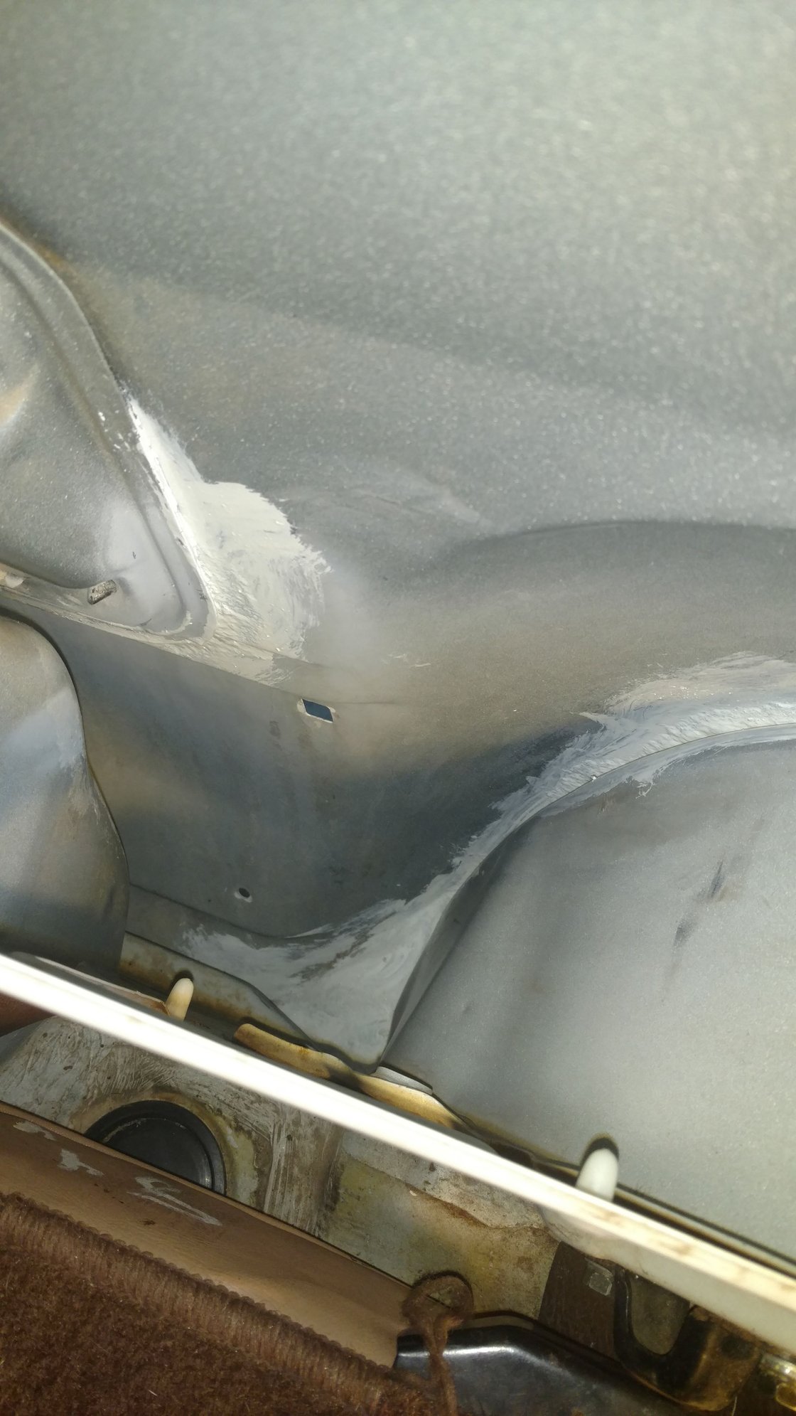

Originally Posted by Heironymous Josch
This is great advice. Should I be concerned with any moisture trapped between the seal and the steel channel though?
Yes to some extent. If it's done sloppy the corners flare out. The tech can seal the rubber gasket with the poly goop also.
I would say that seal job you have was done in a hurry with the function over form philosophy for sure.
There's nothing lazy about that reply! Striking gold right out the gate! Also, it's good to meet another yota dude from CO. I'm actually from there, moved to NOLA a year ago. I saw that truck with the pastel eagle and the sun on the hood, it actually looked like a pretty solid truck. Not sure what part of CO you're in but maybe you saw me getting around in my old 88 PU years ago. The cab was covered in astro-turf and the bed skirts were cut off and what was left of the bed and the camper shell were painted in crazy day-glo murals. That truck was an absolute rust bucket so I painstakingly applied astro-turf to the exterior, looked like it was painted on. I've got some pictures of that monstrosity kicking around somewhere.
I'm gonna get her to a manual carwash this weekend to blow crud out of as much as I can and start isolating any fluid leaks that will lead to ongoing crud build-up; I've already identified one coming from the power steering pump.
I've used polyester resin heaps in fibreglass fabrication and glazing putty specifically in fibreglass form construction. Should I use give the holes a couple of little taps with a conical punch to recess them a bit first?
I was thinking something along the lines as you said for the gate, thanks for the specific info. The driver door's a bit clunky as well; I'll pull both panels this weekend and inspect all the hardware and mechanisms.
Thanks again for all the good advice!
Lol I think I might have seen the AstroTurf one!
I've got leaks in my PS also, primarily I think it's the hose from the resivore on mine. It is ATF so not really to worried about rust as long as it's wet all the way thru whatever gunk it collected.
For sure pean down any puckering at the screw holes so you don't have to do any build up around them to blend them in.
​​​​​​​I've got either a loose mount or a blown bushing on the passengers door too and can hear it "pop" about 1/3rd open.
I am super worried about safeguarding the truck from the Louisiana climate. I'm considering removing body panels and applying a finish on the back side to prevent rust. I wonder if anyone out there has done this and can recommend a good finish for this purpose.
Agree about clearing the drain passages first. The inner panel coating isn't a bad idea, but you can focus on just a couple areas that will rust no matter how well the drains work: the inner wheel well to quarter panel seam and around the inside of the fuel filler panel, shown in this photo from mine. It's been in Northeastern Ohio for 4 years and needed some attention. I used KYB rust seal which is a moisture-curing urethane similar to por-15 and rust bullet. Any of them should do the job as long as the prep work is good.
Thanks, I'll definitely be having a look there. I've used POR 15 in motorcycle tanks before, I'll look into the KYB product.
I did get it in the knick of time. Beyond the screws in the pillars, there are 5 holes on the roof above the windshield where someone must have previously installed a visor. The screws have been removed and big globs of silicone put in their place. I may give these areas attention sooner rather than later before rust gets into them. For all the screw holes I plan to weld in small backer plates, filling the holes with the weld before filler, primer and paint.
Ugggh. POs. Some folks just have no business modifying anything. Glad to see this rig in good hands. Congrats and the stripe work is badass as far as I'm concerned.
POR15 and other rust converters are fine, but they are more oriented towards repair work vs. maintenance or damage control. The prep has to be just right for these products to work well. If you are just trying to keep the rust at arms length there are some products designed to do exactly that. One is Waxoyl, which is a tried and tested product used by many auto manufacturers at the factory. Another choice is Rust-Guard made by a company called Jet-Lube. RG was designed to be used on off-shore oil rigs to combat rust. Both of these products kinda spray on as an oil and then dry as a waxy overcoat. CRC also makes some Corrosion Inhibitor spray which, imo, is okay but not as long lasting as the Waxoyl or RG.
If you want a more oil based product that will creep into seams, crevices and inside the frame, check out a product called Fluid Film. This is more of an annual application type oil, but is far better than using say WD40. Fluid Film is sold everywhere. I think I saw a can at Lowes the other day.
