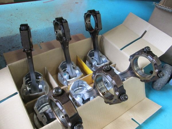

box of goodies
For some reason, I liked the color scheme on the box.
I must be feeling those endorphins right now. ^_^

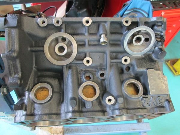

just got a call from the machine shop. the block's done! Wish there were more hours in a day to go pick it up and start working on it. :-/

I know, it's about time something else happened to this engine. I'm already forgetting what parts go where on the engine- it's been too long!
tried to get most of the old paint and rust off, then primed and painted (high temp engine paint in a rattle can).
cleaned as well as I could
masked...
and painted!
new cross-hatching. <3

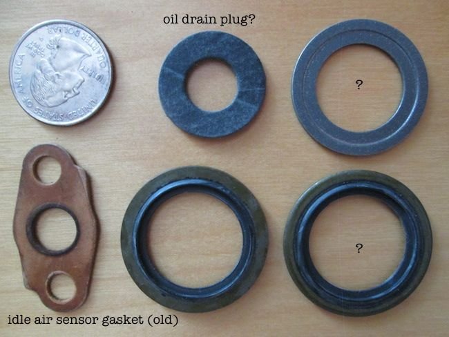

seal ID
couldn't find a part number for the idle air control gasket (no longer available?), might just re-use the old, since it's in 1 piece.
Any ideas what the other seals might belong to? They look familiar, but I can't recall actually removing anything that looked quite like them from the engine (unless they're still attached to the connected parts.
I know a few of these:
The quarter is for you hurricane dispenser LOL
That idle air sensor goes with your EGR valve to the manifold
And the one on top center looks like one for your oil drain plug which you can get at AutoZone or O'Reilly's
For the other 3 im not familiar with them and your engine so far looks amazing.

^^the quarter's actually for the laundry machine. :p smartass, haha.
I know WHERE the idle air gasket goes; I just don't have a part number for it if I decide to order a new one and replace it.
dang.. it's those three that I don't have a home for.

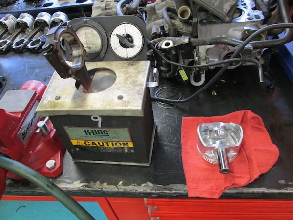

Monday, my day off, so....
injector 'cups.' only have to replace one
cleaned the outside of the injectors. ordered 'repair' kits that have all the gaskets and pintle cap and filter. Going to sonicate these later
new vs. old
preheating to 1000F ouch!
pressed the pins in and centered them before everything seized
all ready to go!

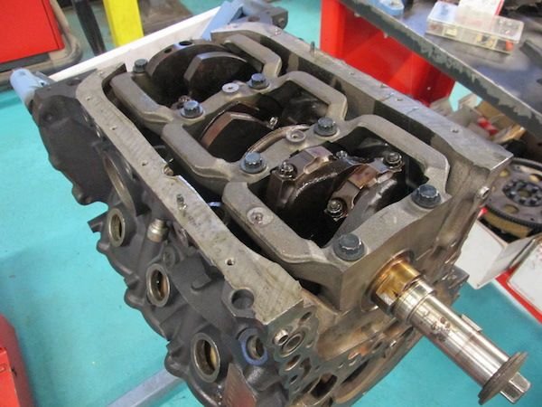

crank's back in place after measuring oil clearance with plastigage
and pistons are in after measuring oil clearance and ring end gap. One of the second years stayed late to help. yay, teamwork!
