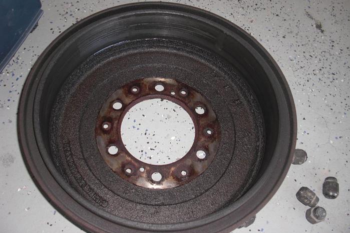

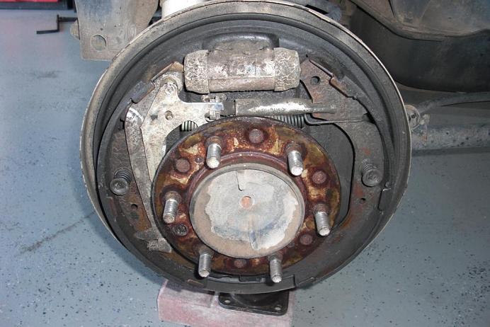

it looks like you need axle seals already that looks like you have had grease seeping into the brake shoe area and thats whats all over the inside of the drum. Thats what it looks like from the pics anyway. Just a heads up my friend greasy rear shoes can be dangerous in certain situations.
That's what 232k miles and daily trips to the beach will do. The rear brakes don't see much action so I would imagine even if they were completely removed it wouldn't be that "dangerous". Besides, my e-brake works amazingly well.
