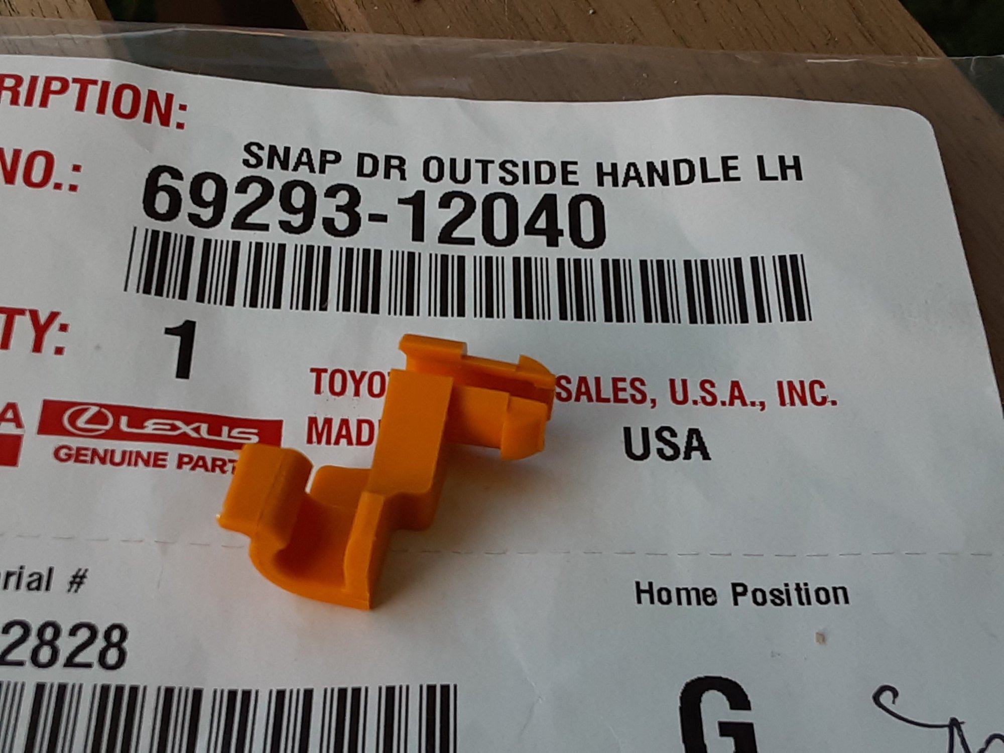

I removed the latch on Sunday to study how the various rods and levers interact to lock and open the door. Incidentally, the "door lock rod clip" that connects outside door handle to the latch was broken. The broken piece was white plastic; the new Toyota clip is orange. When I had latch problems 10-15 years ago, I probably installed an incorrect part, which led me to problems with the linkage that might have been diagnosed as "too short," which seems to be a symptom that appears frequently.
Photos attached, with annotations: unlocked, UNlocking, and correct clip.

The correct Toyota part number for the clip that connects a rod to the driver door handle is: 69293-12040. $4.15 at my local dealer.
In summary, there were two problems that locked me out. The clip connecting the outside handle to the latch was broken, and two parts on the latch were colliding that prevented movement of part D to its unlocked position over E.
