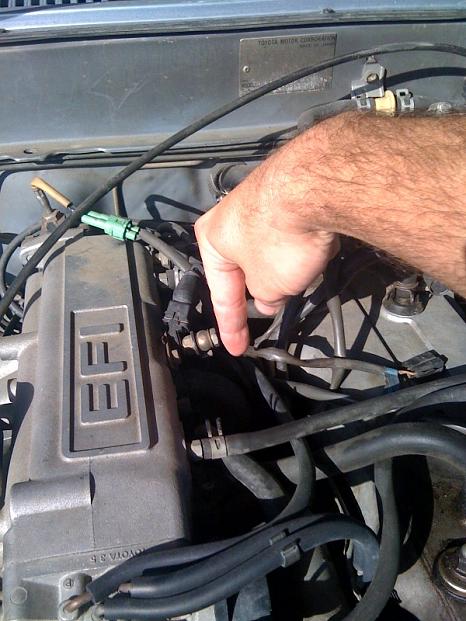

My Temp gauge has been going to normal temp immediately after cold start, then never moving. This morning on my way to work, it just quit.
I bought a temp sender but it didn't match what I thought was the the one I need to replace.
The first pic shows what I thought was the one, in between the plenum and valve cover, with blue wire clip.

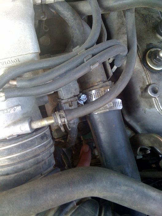

The second pic is what I had hear might be the one for the ECU, Not sure if it is the brown or green? Just under the TB and to the right.
I have an transplanted SR5 cluster, in a 88 P\U 22re.

Yes the one by the TB is for the ECU, the one between the plenum and valve cover is for the gauge.

Thanks, but for the record, the one that does the ECU, is it the brown or green?

I did a better search and found my answer. The sensor that goes to the ECU is the one on the right, and its green.
I bought a new temp sensor for the ecu. I figured I'd change that also. The one I bought from Autozone was maroon like the cold start switch next to it. I realize that the aftermarket doesn't' necessarily care about colors, but I thought that I'd just ask in case someone has done this recently.
Is this the right sensor?
Duralast SU405
