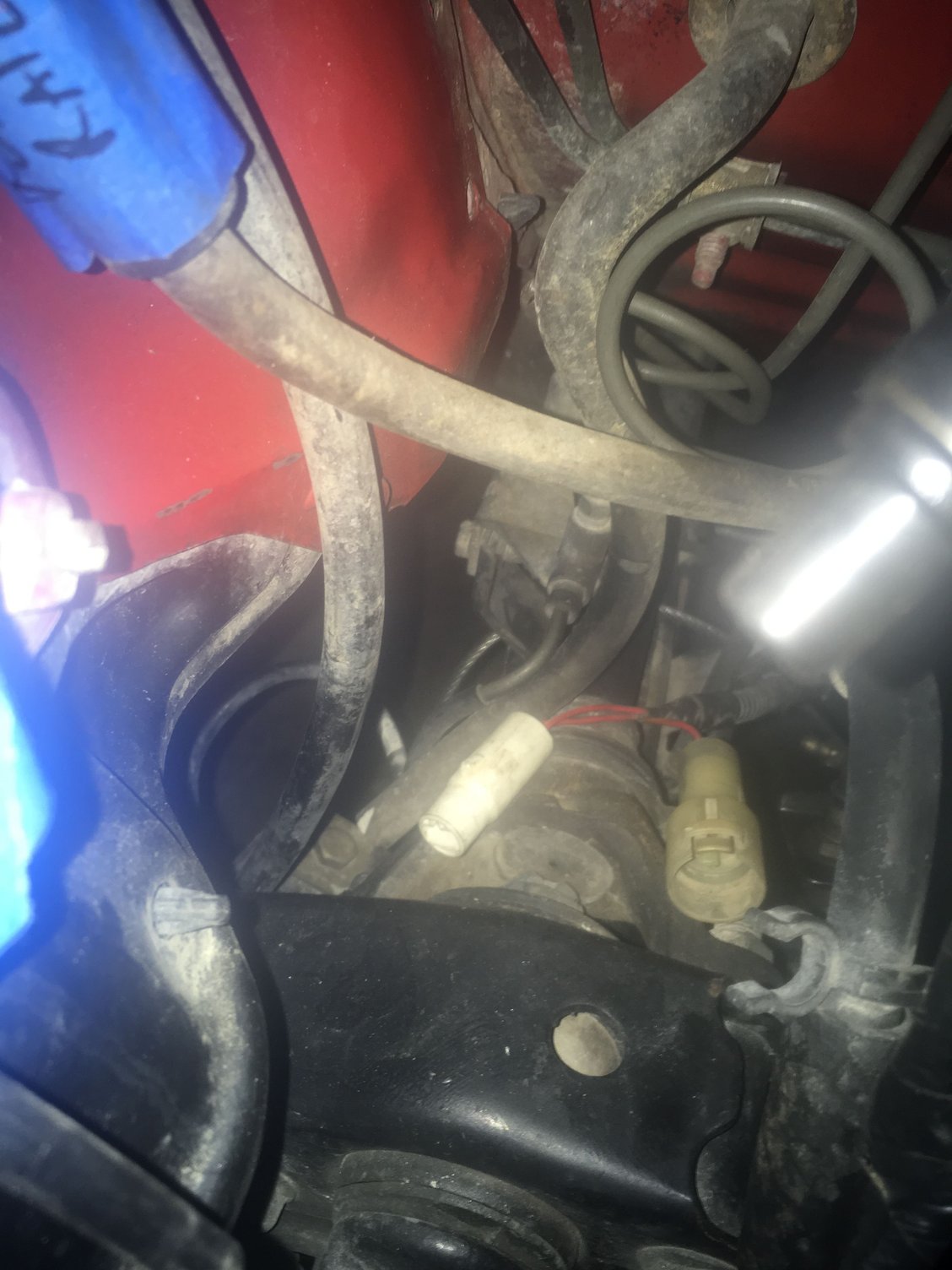

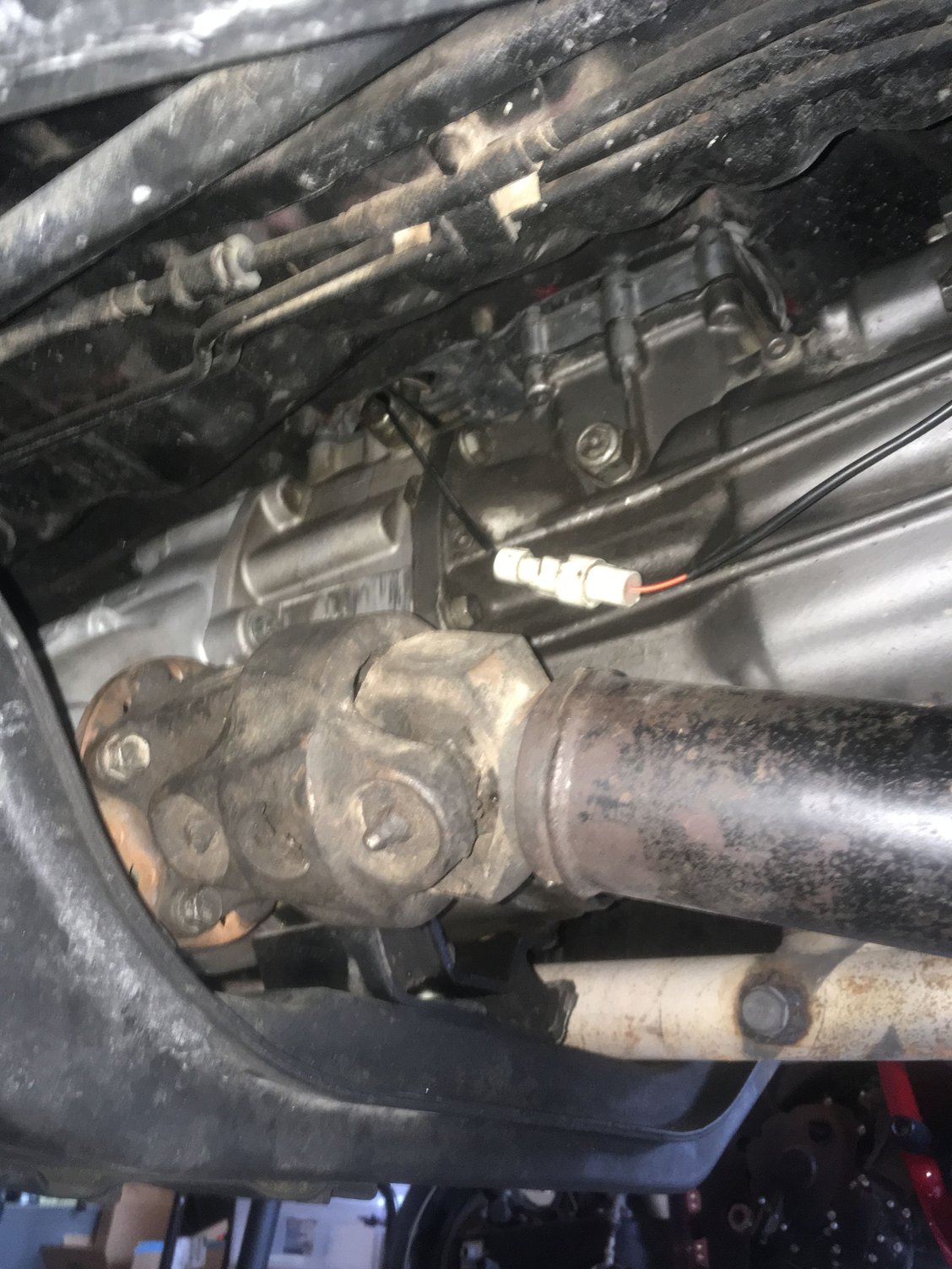

First problem I want to address is fixing my reverse lights and 4WD indicator light. The switch on the side of the transmission case has wire that are broken and I cannot find the information on where they go. Where are those wires supposed to connect?

Is it the connection on the passenger side of the transfer case? I have the 22re, its probably not the same but it may be close

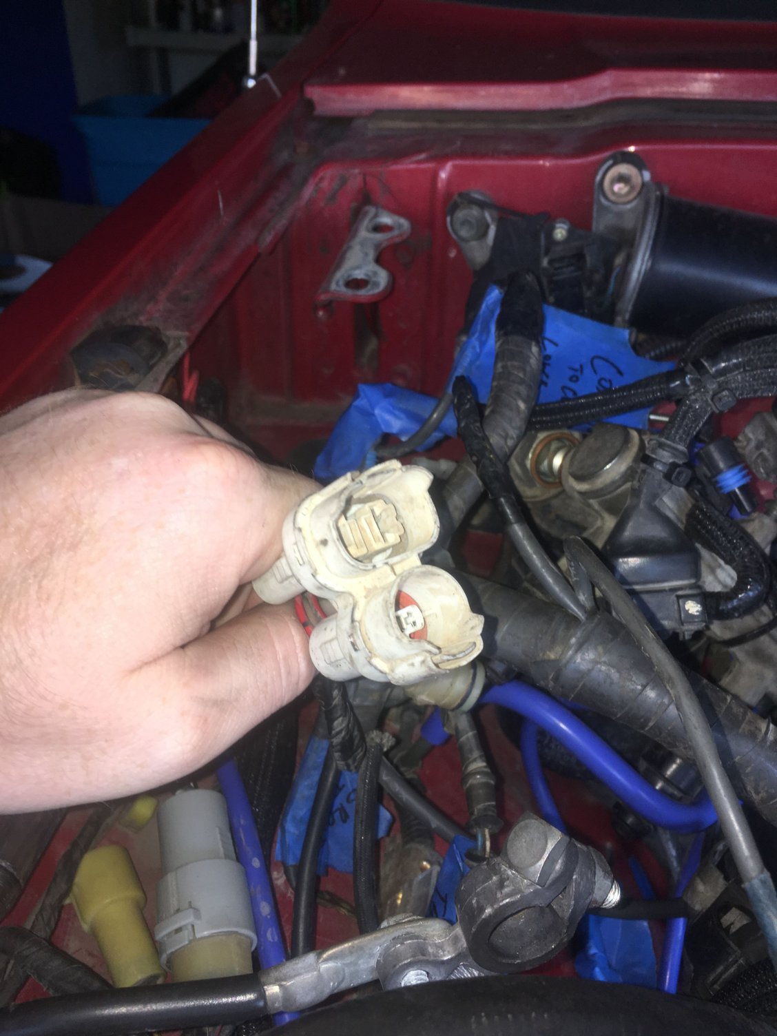

This is the connections on the 22re
It connects to the bottom piece

Those pics help me a little. You are holding two plugs? If so, which one comes from the switch. If both plugs come from the switch, where do they plug in at?

Sorry about that. The plugs I am holding are what the line connects into. It connects into the bottom one

The white plug on the left comes from the transmission near the shifter on the driver side (reverse light I believe), the other single connection is from the transfer case

I have three plugs in the location on your truck. The two that you have plus an extra one.
Three wires red coming out of the switch on the teams case. One red. One red/yellow stripe. One black.
The "extra" third plug, which is female, has only one red/yellow stripe wire attached.
The other plug, which is male, has two wires. One being red and the other being red/white stripe.

Alright. I have three plugs in the engine compartment as well. One of them I don't use. Are those ones intact and you just need from the transmission to those connections?

I have rewired the switch coming out of the transmission case back to its corresponding plug. Plugged it in and BOOM! I have reverse lights now. The two wires on the switch are RED and RED/WHITE STRIPE.
Plug is also same colors so it made it obvious as to which wire belonged.
So so my question now is... What are the other two plugs for? The plug that is not attached to the reverse plug was connected to a plug with only one RED/RED YELLOW STRIPE wire coming from it.
The he plug that is attached to the reverse plug is empty.
