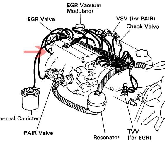

Originally Posted by linuxrunner
Where is the vacuum booster hose? i figure something like this is most likely the problem. I honestly had NO idea what i was doing when i first started working on this thing now thanks to yotatech and messing around i have slightly more than no idea, it is likely i put something back together wrong, or forgot something.
Check out this link...it depicts some of the vacum routing:
http://personal.utulsa.edu/~nathan-b...14layoutan.pdf
and EGR:
http://personal.utulsa.edu/~nathan-b...18egrsyste.pdf
Old Mar 2, 2006 | 10:25 PM
  #27
linuxrunner's Avatar
Joined: Nov 2005
Posts: 856
From: Gladstone, Oregon
thanks for the diagram, everything looks right. I was just wonderin, when i pull this tube my idles gets a little smoother. Is this right? maybe i'll try cleaning the EGR tomorrow morning, how do you get that cover off? maybe this will help my idle.
