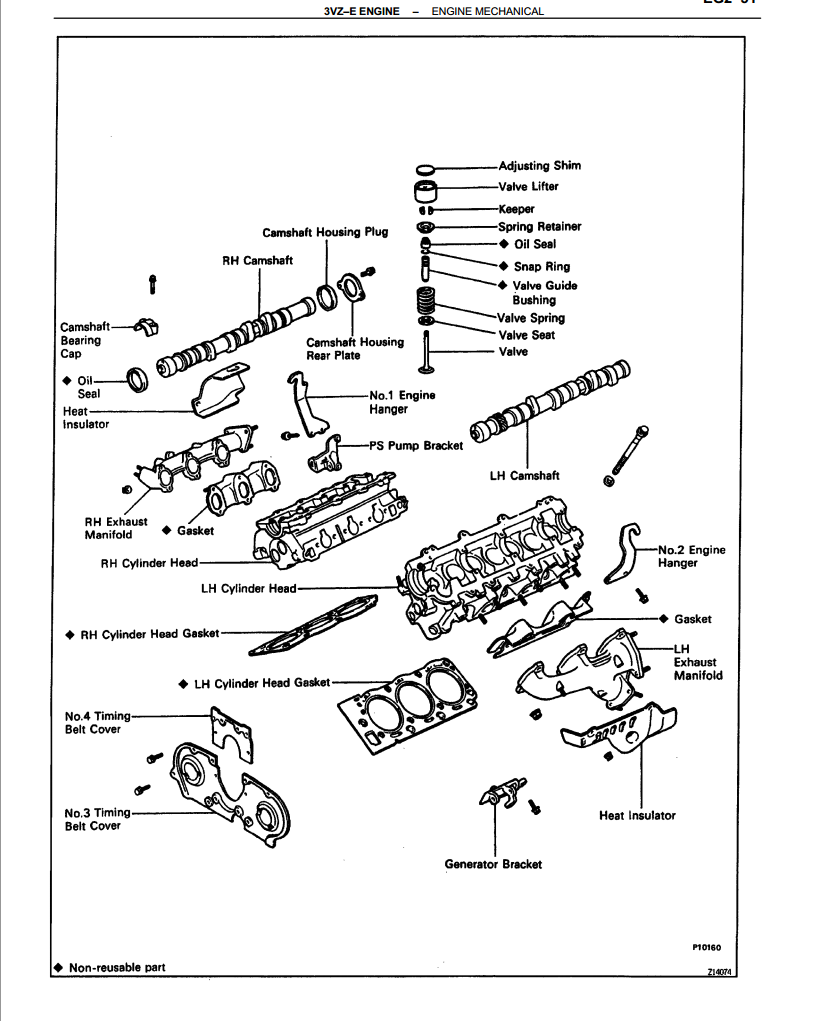

The 3vze has hydraulic lifters with shims that sit in a shim bucket on top of them. Valve shims are a serviceable item and valve clearances should be checked. It can absolutely be the cause of your noise. Get a length of rubber hose- hold one end to your ear and move the other end around the engine and see where the noise is coming from. Also you can use a long screwdriver in the same fashion.
Fuel pressure regulator and injectors are notoriously loud on these motors yet aren't cause for much concern. Give em a listen.
Unless we are talking semantics, and what I'm calling a "hydraulic lifter" is technically called something else?
edit: taken from 95 FSM

No.
3VZE does not have 'hydraulic lifters'. Such are self-adjusting and do not require shims to take up valve lash.
Old Oct 3, 2013 | 09:30 PM
vasinvictor's Avatar
iTrader: (3)
Joined: Jun 2008
Posts: 1,979
From: North Central, AR
But to say the "lifters" couldn't possibly be making noise doesn't seem right. The valve clearances between the rockers and shim could be, and often are, out of spec and cause "lifter noise".
I knew Id be wrong somehow on the "lifter" thing. I didn't mean to throw the hydraulic part in there. The FSM most certainly calls them lifters. So I'm just now sure what else to call them. I don't see a reference to the word "followers".
Old Oct 3, 2013 | 09:42 PM
abecedarian's Avatar
Joined: Mar 2008
Posts: 12,723
Likes: 6
From: Temecula Valley, CA
Yeah, it's a conflict of terminology, which I attribute to the older V8's with hydraulic lifters- they pump full of oil and have a check valve that keeps oil from flowing out and thus take up valve lash automatically. Anything else similar- shim and bucket for instance, I call a follower as it follows the cam lobe.
A loose valve, one without a hydraulic lifter or follower, shouldn't happen- the lifter / follower should take up clearance automatically.
An exhaust leak will be louder under acceleration and likely disappear when off the throttle.
