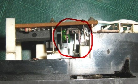

I have this component burntout on my master switch as I have the same problem as above my driverside window dosnt work at all and the drivers side rear goes down but not up can anyone tell me what this component on the circuit in the switches is so can solder a replacement there are no markings visible and the repair manual does give a spec for the parts and the board.
Cheers
