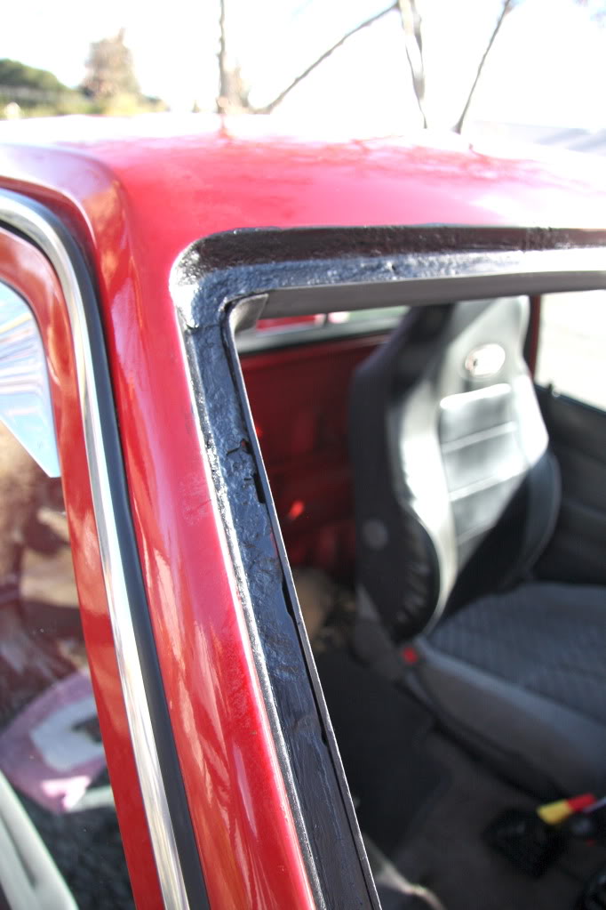

Had my windshield replaced today. I'm happy to report that there was a minute amount of rust. (Pics coming, they are on my phone). The windshield had been replaced before by the previous owner from the looks of it, and the seal was an absolute hack job. (No pics of that)
Now on to bigger and better things, like the timing belt, adding a rear bumper (didn't come with one), suspension overhaul, new tires, brakes, etc.

Other pic...
