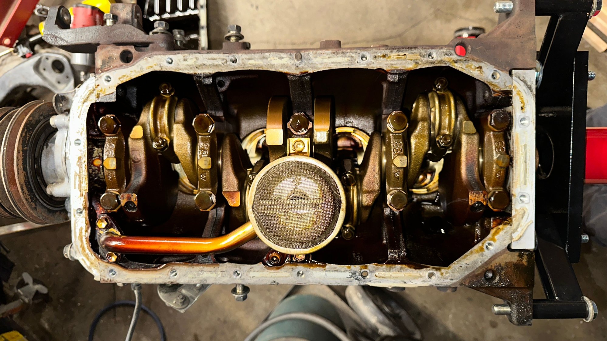

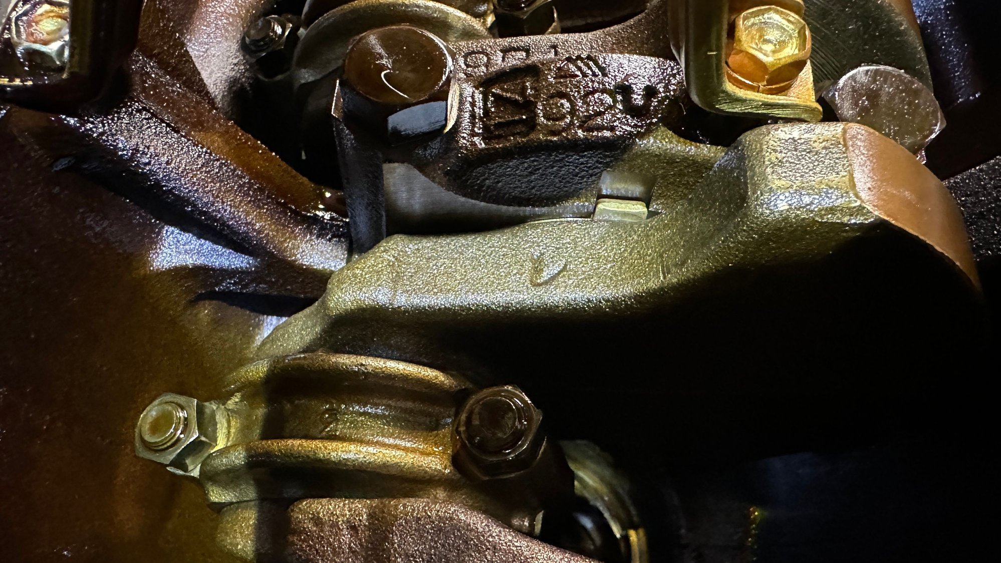

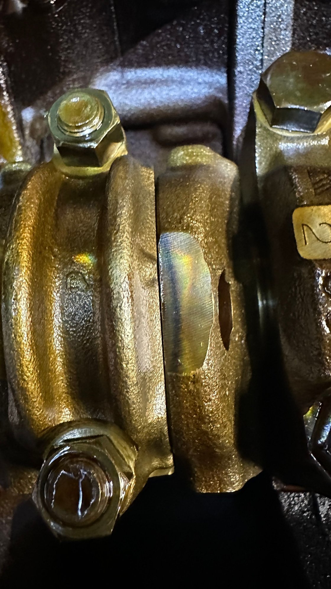

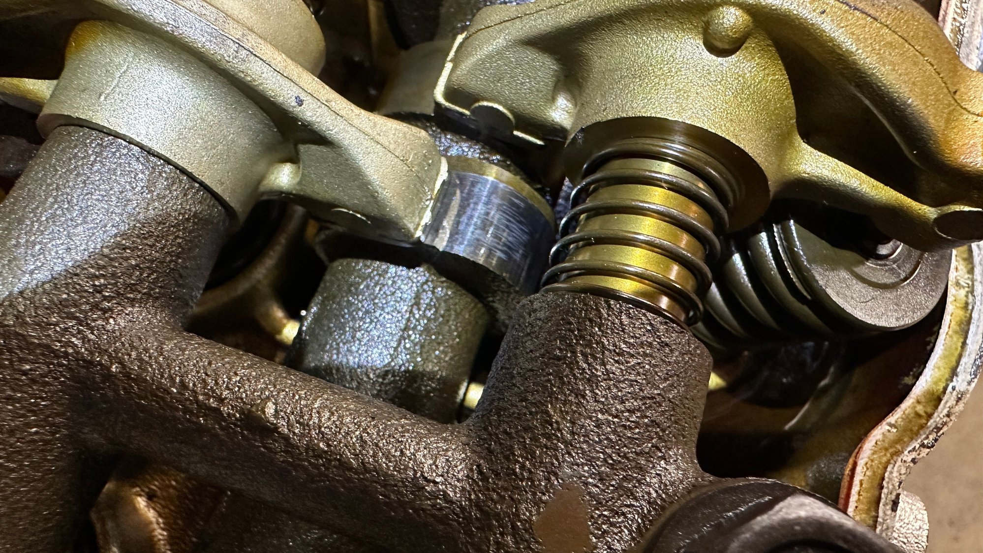

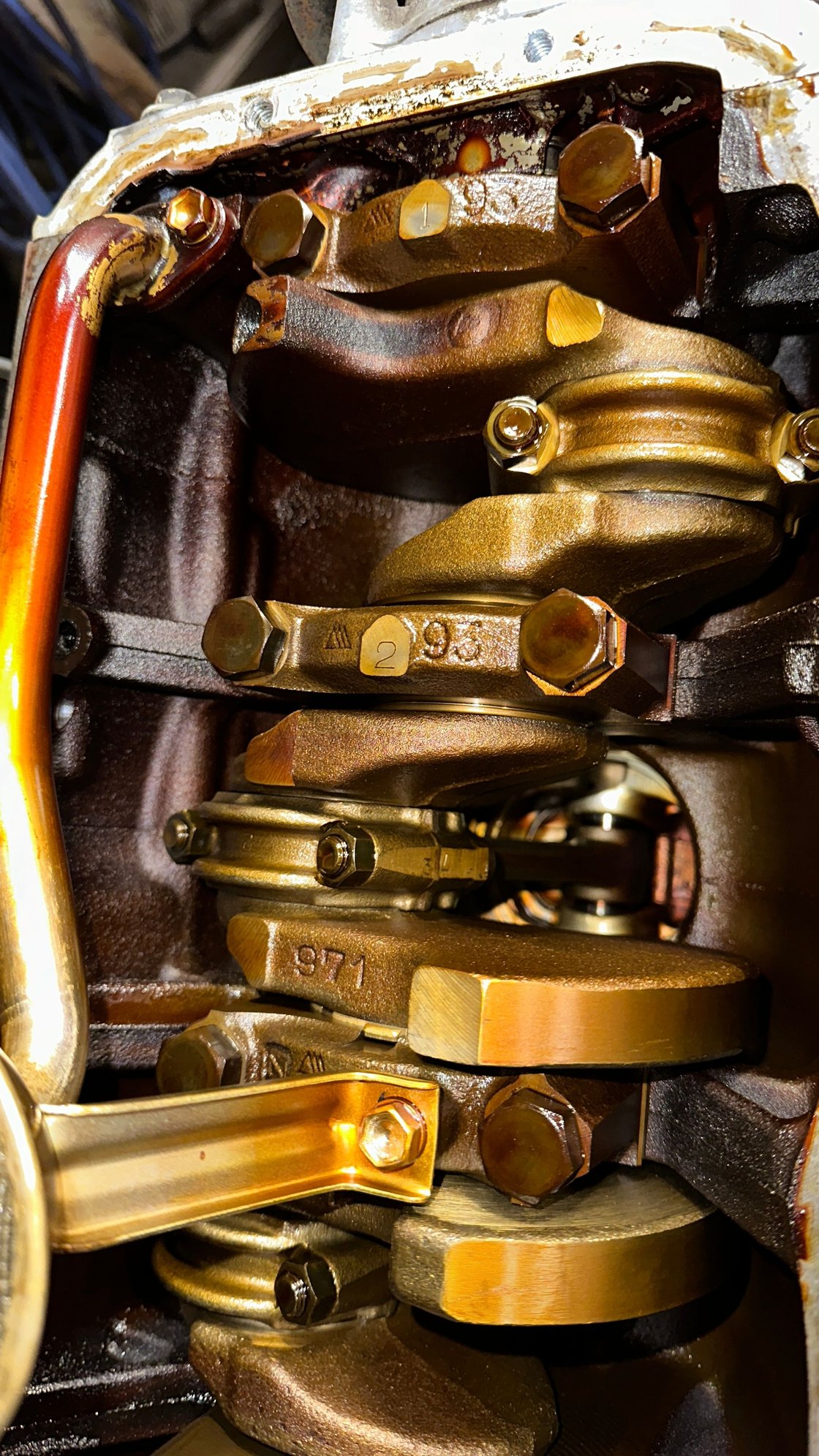

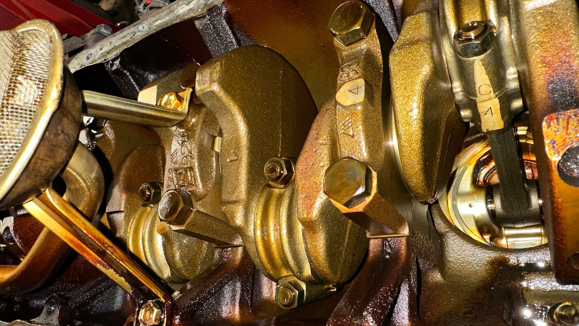

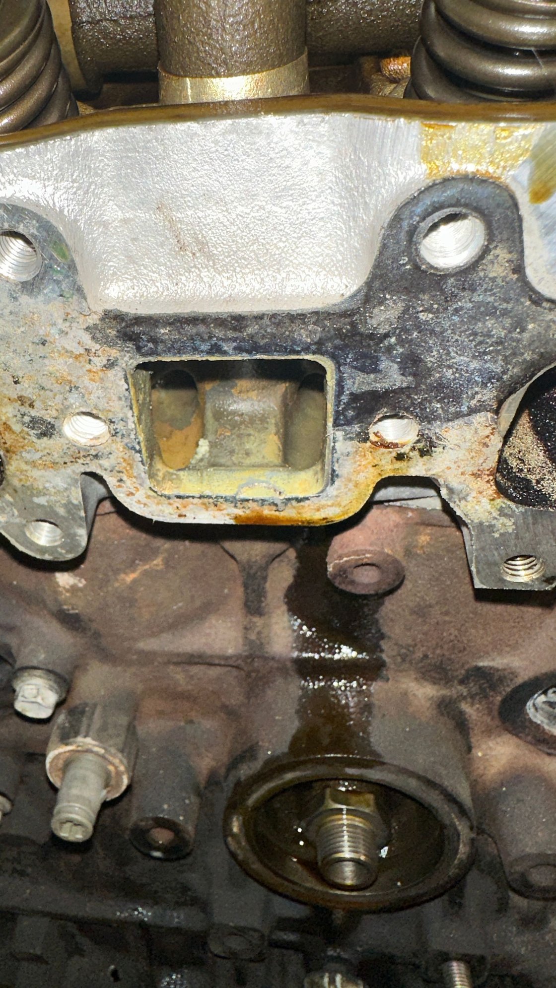

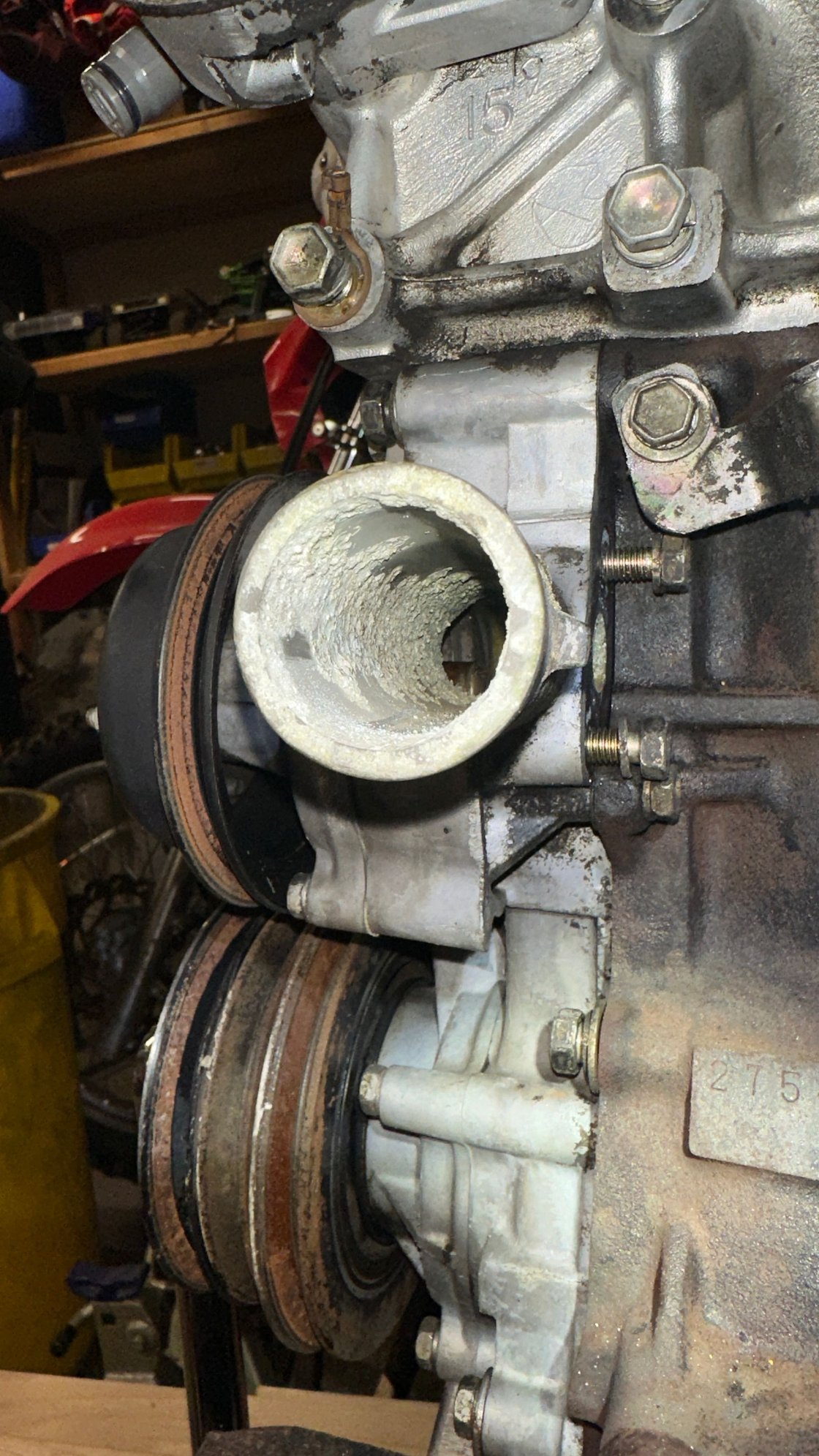

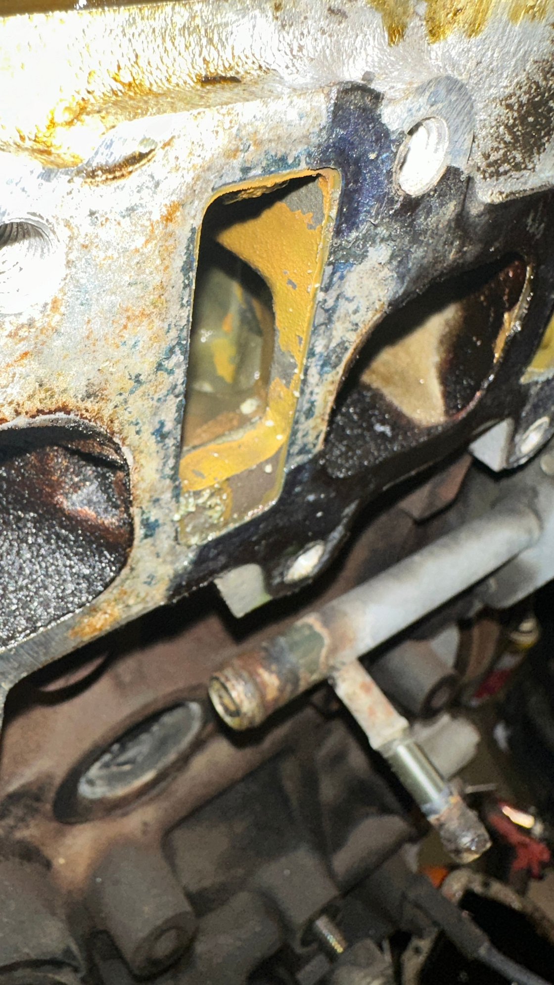

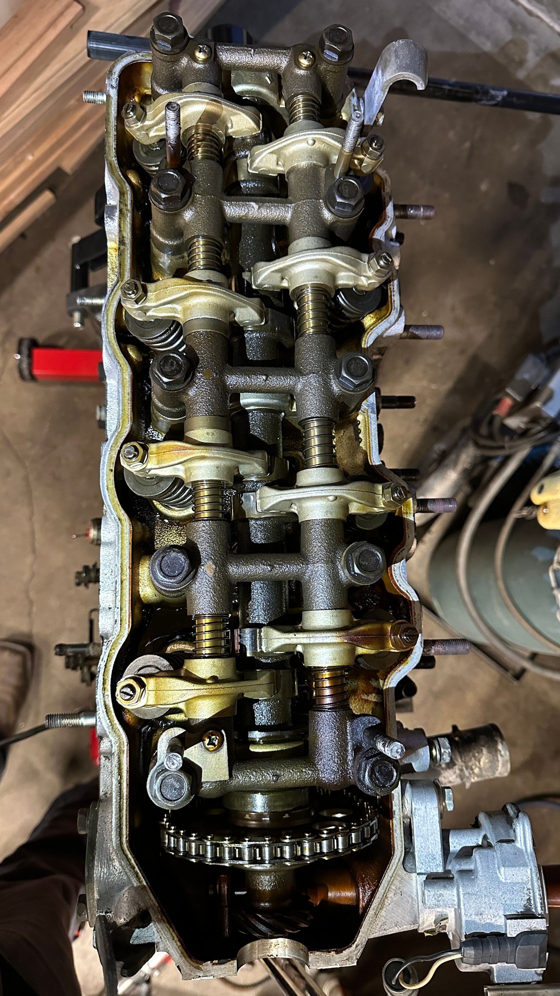

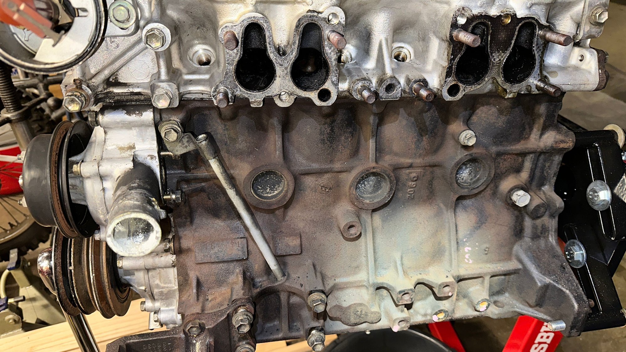

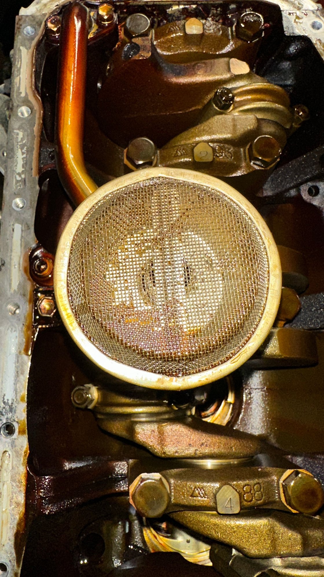

Some photos of the inside of the engine
timing chain is a did Japan and appears to be original. Has the factory timing gear and appears to be in brand new condition other than the edge of the timing chain guide being broken off.
cylinders look great other than very minimal vertical lines. Couldn’t feel them at all though. Cam looks beautiful, only finish wear appears on the tips of the lobes.
only weird things I’ve noticed is the vacuum distribution thing, forgot the name, had oil in it and the exhaust ports on the head are super moist with oil/carbon. Maybe this thing got rolled?
Cooling system looks like it’s seen better days, maybe cause it sat outside for a few months in a junkyard? Any tips on cleaning that out?

The water pump looks like it has silicate deposits. I would definitely put a new water pump on it.

I would pull a main and rod bearing just to see if they are stock sized or may have been replaced. Plastigage for clearances and also do a compression check for the full health picture
