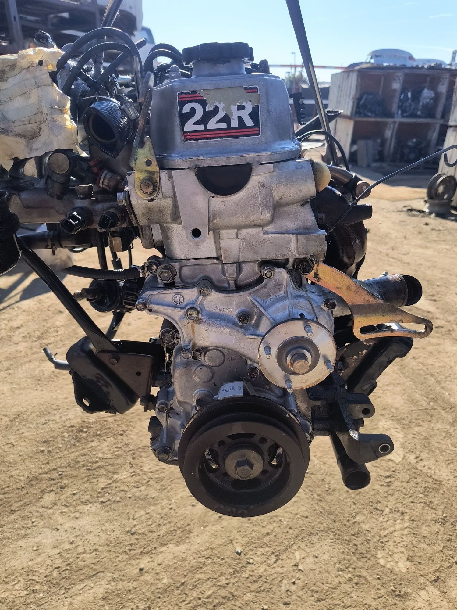

New question for yotatech but don’t want to start a new thread, what’s a solid way to ID an oem Toyota short block/head? Local junkyard has a 22re out of a 2wd I might grab to rebuild, but I’d like a way to verify it hasn’t been opened up or rebuilt with remanned parts in the past. Any way to do it without completely tearing it down?

I doubt you'd run into a non-oem block. Bored out maybe, but not aftermarket.
Head and cam are the risk. The cheap Chinese cast heads and cams were so cheap that to many it seemed better to buy than machining their oem head. I've pulled parts off a few wrecked 4Runners where the head was very noticeably cleaner than anything else under the hood.
I can't find any great way to readily distinguish the two different heads. At least not by looking strictly at the head. What might be useful is i saw where the valve spring retainer that sits on top of the valve spring was noticeably thicker on the Chinese head vs. oem. Valve lip was a lot thicker, too, but on that you'd have to pop one out to tell. Valve spring on the Chinese head was a lot stiffer, too, but again, hard to tell on the fly.
I think I saw where someone (LCE?) posted that the measurement from the bottom of the 1/2 moon cam journal to the head surface was 3.13". Wouldn't tell you oem vs aftermarket, but would tell you if head has been decked before.

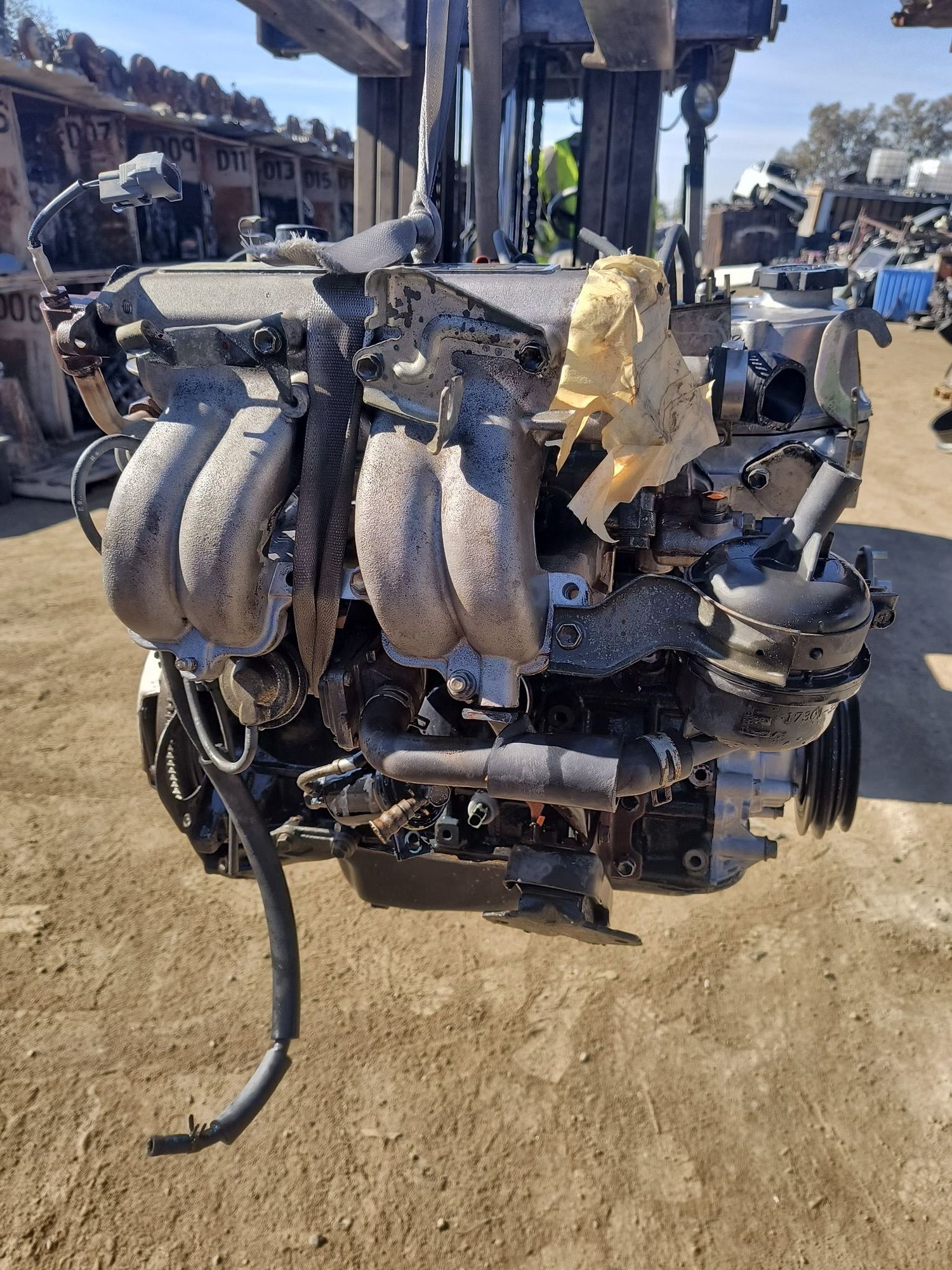

thanks for the tips. The guy sent me some pics, looks decentlyl taken care of and evenly clean from valve cover to oil pan.weird that it has a 22r valve cover sticker when I don’t think those covers ever came on the carb versions?
has aisin cover and pump, honestly has less oil residue than my engine. Even appears to have a 4wd oil pan. Gonna turn the crank by hand and look in the spark plug holes, if it looks good I’m gonna buy it instead of the LCE.

The valve cover on my carb'd 22r has the 22R sticker.
The guy I bought my truck from 12 years ago told me he'd put a new head on it. I bought a valve cover gasket set some years after buying it. The kit half moon inserts didn't fit. Can't remember if too big or too small. I also ordered the aluminum half moon inserts from 22RE Performance. Those didn't fit either. I figured the head the PO put on it had to be aftermarket which is why the inserts were not fitting.
There's someone in my area selling rebuilt 22Rs. Check out facebook marketplace for Raleigh NC. There are several postings for rebuilds. I think the same people. One post they're rebuilding with 22R block and 20R head, $1350. Another is a performance build using Erson Cams, Safety Pistons, and Safety Timing components for $2500. Third posting shows stock reman for $1075.

I’m pretty sure it’s a 22re head/cam and that sticker is just aftermarket. The casting marks look pretty similar to what I’ve got. Plus it’s got an erg temp sensor so it’s probably 1993 or newer, wouldn’t expect that to possibly have a 22r head on it.

They left a lot bolted on. Motor mounts, manifolds with sensors, mounting brackets, etc. You could eBay whatever you can't use and recover some of your costs.
That is a clean engine. Maybe the yard pressure washed it, but that's be a first.

yeah plan is to sell the manifolds and keep the sensors/vsv if they’re the same as what my 1990 has. Those are getting hard to find/expensive these days.
I think they did pressure wash it cause the exhaust looks shiny in those photos.

I went and checked out that motor, photos looked great, was a hunk of sh** in person. Blown head gasket, and the head/cam looked cobbled together.

I was going to say, I bet that engine had been opened up before.
I think the valve cover was off of another engine, or the engine was converted from a 22R to a 22R-E.

something goofy was going on. It had a weird ring on the end of the cam I’ve never seen before, and the pistons were stamped .050 so it has definitely been opened before. Guy looked shocked/didn’t believe me when I told him the head gasket was blown when I was looking at cylinder #4 till I yanked the valve cover haha. He told me he’d have a new 22re for me tomorrow, I’ll see how that one looks. At this rate I’ll be installing the LCE
