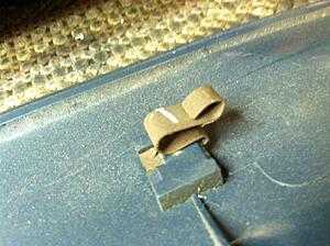

I have heard many horror stories about removing the stock pillar cover. It really isn't that bad, I had it off in under 1 minute. Here is how it clips in there.
EDIT: Here is the exact pillar I ordered, http://www.lceperformance.com/Gauge-...-p/1099112.htm
A little force with a straight screwdriver and it popped right out.

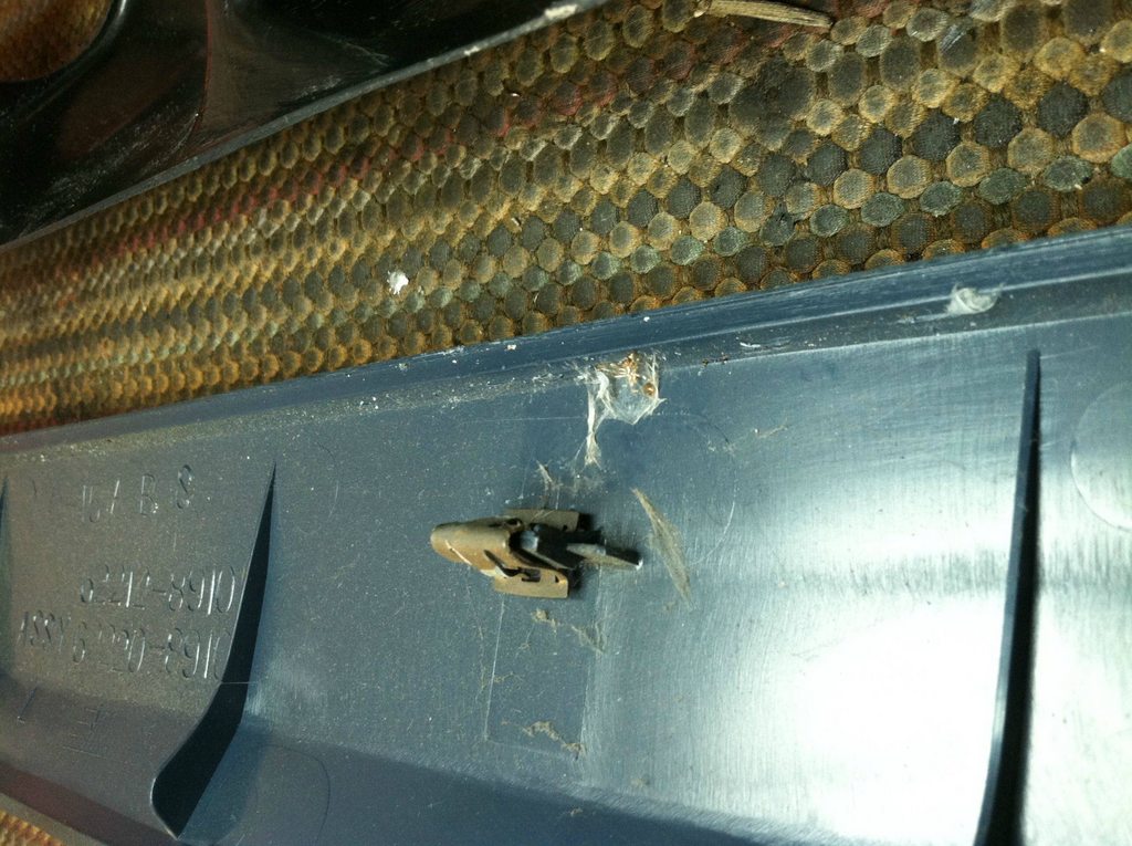

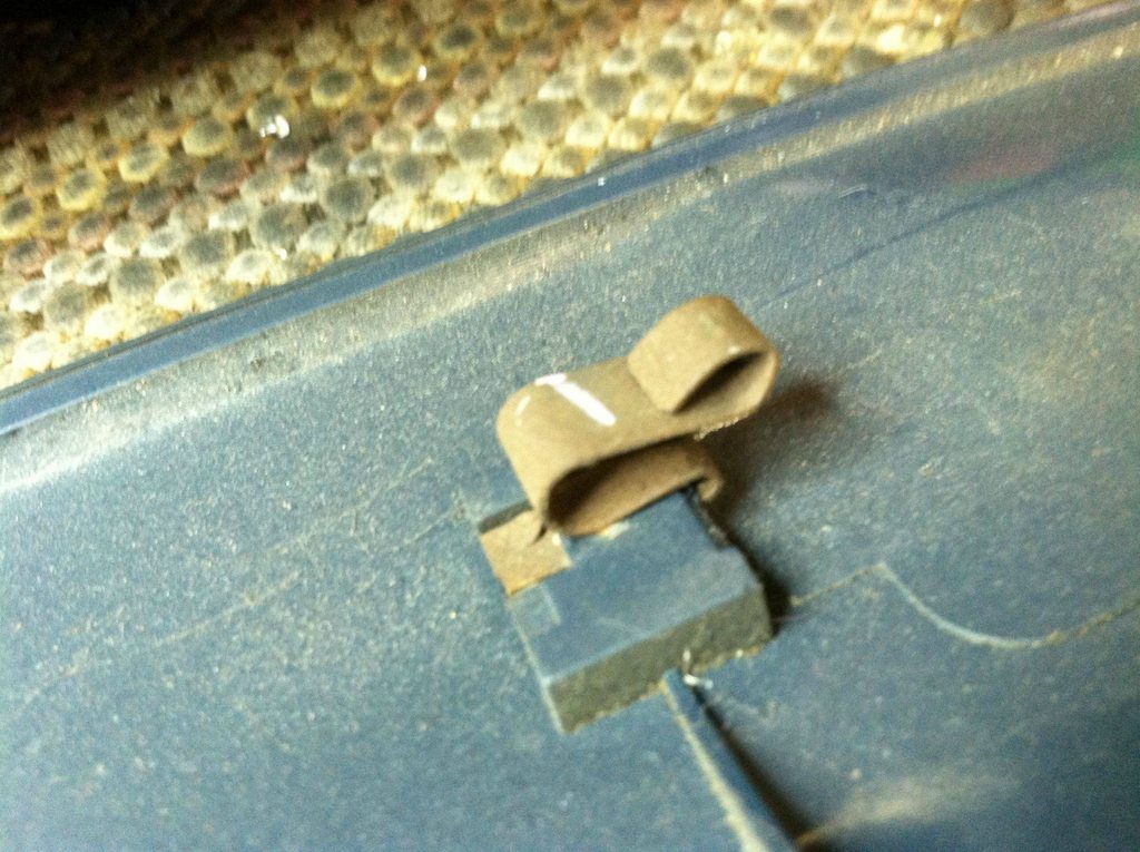

The bottom of the stock pillar is hooked into the body with this. Just lift up and it slides right out.

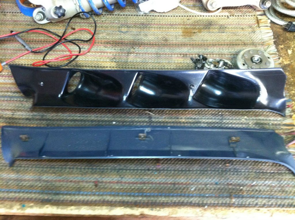

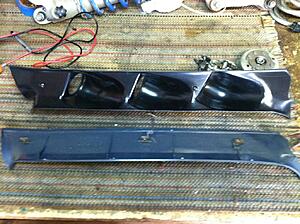

The new pillar next to the old one.

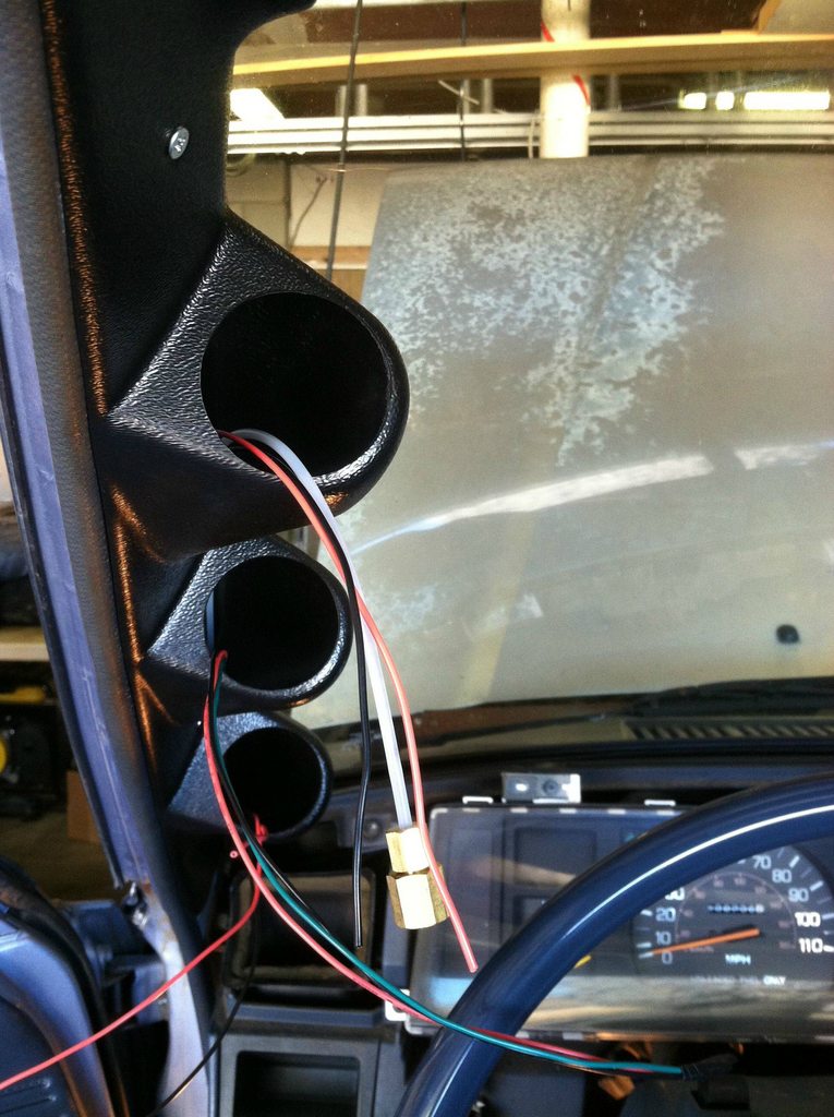

Installation begins, I had to drill two small holes into my truck body to mount the new pillar.

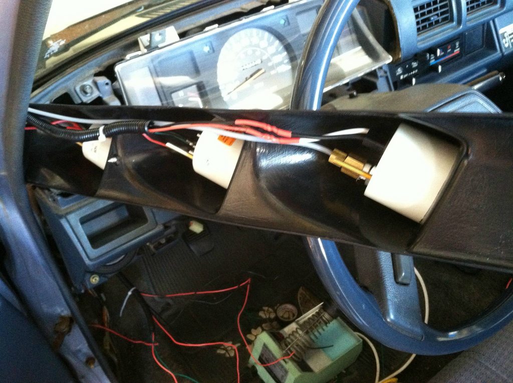

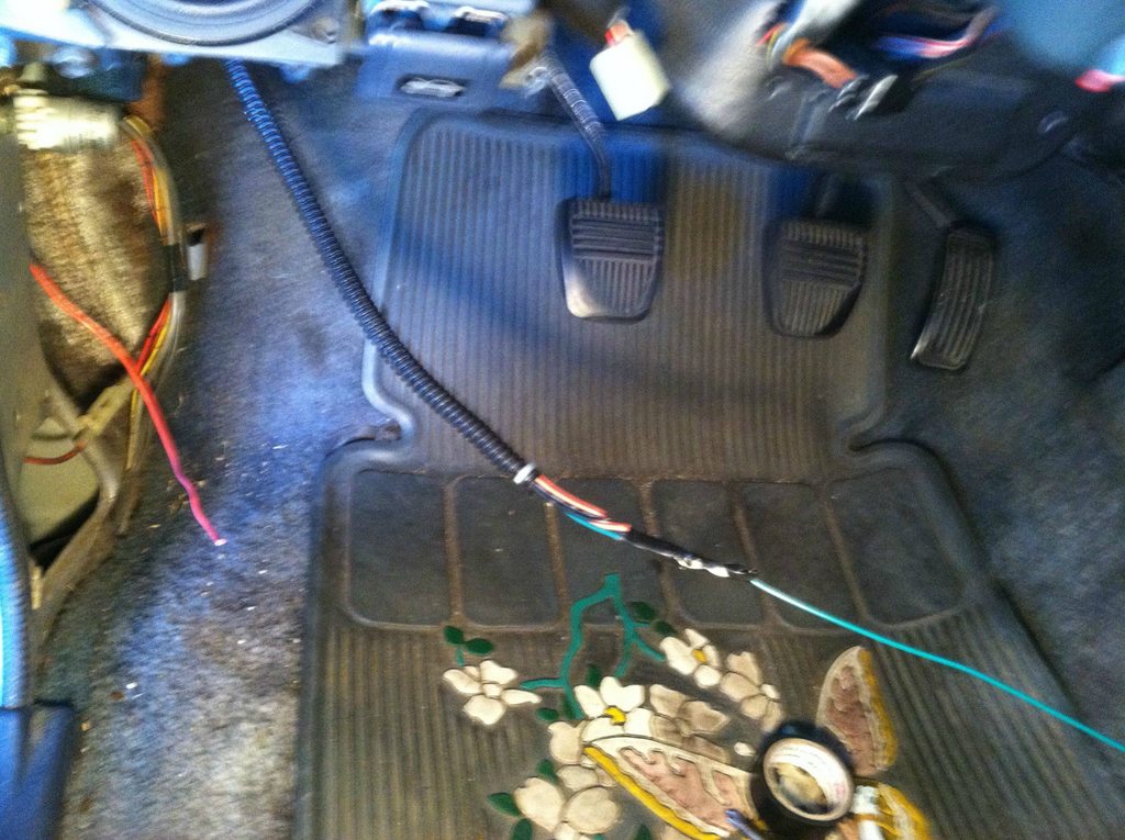

Some wire looming, trying to keep it nice.
The other end.

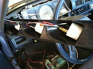

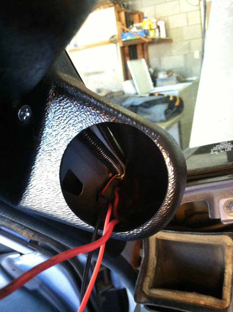

Almost there.

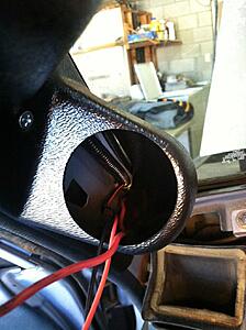

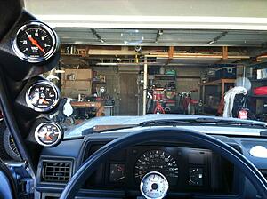

Inside

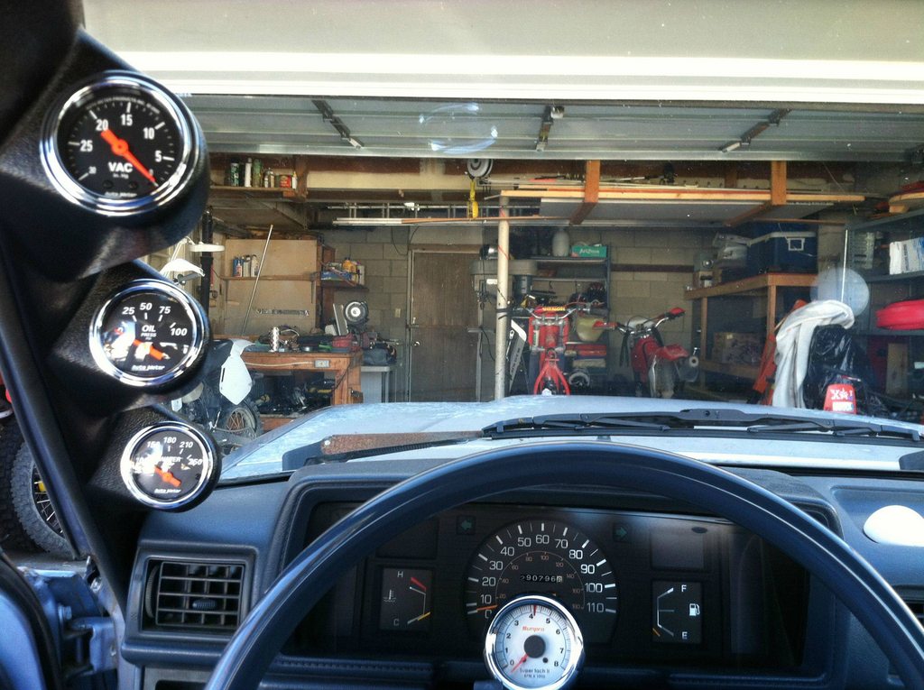

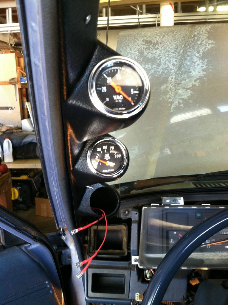

Finished product.
