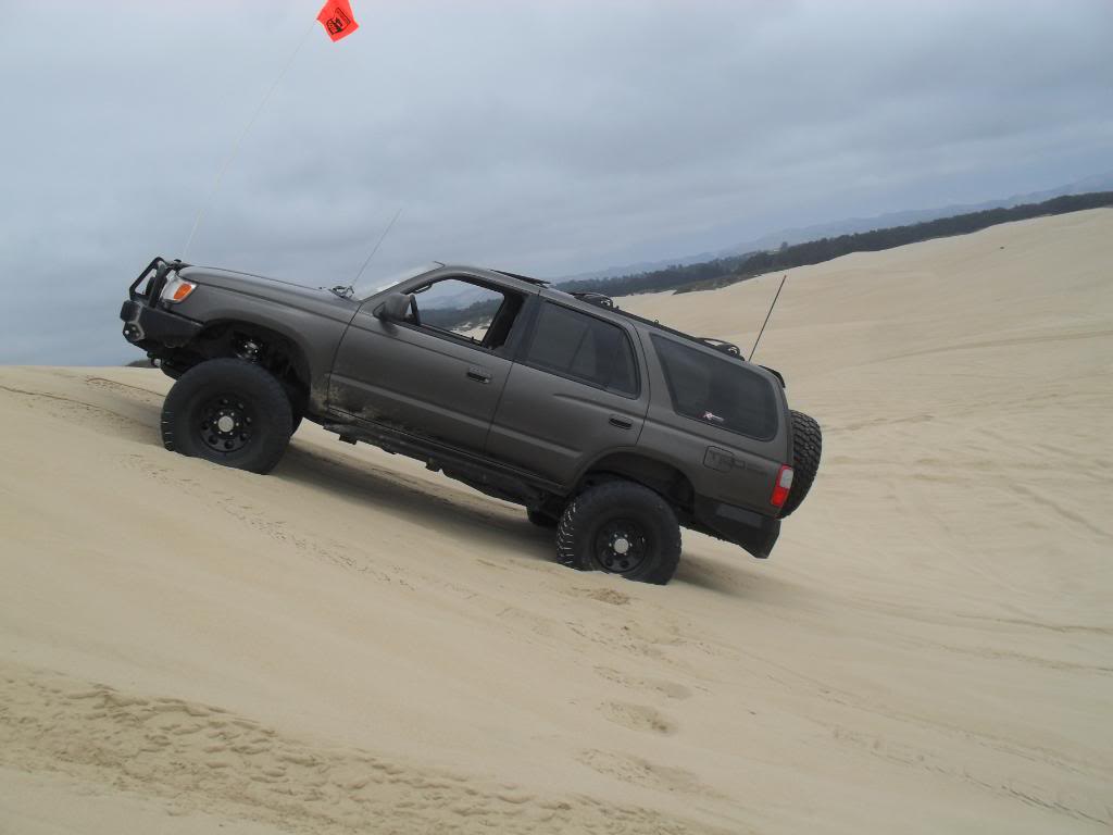

LC coils are great because they provide a ton of flex and a comfortable ride. The downside to them is they also create a lot more body roll than stock, and sag much more under load. If you plan on having frequent heavy loads in the rear or towing often, get yourself some 9 wrap coils instead of 7.5 or 8 wrap. My 9 wrap coils provided about 5.5" of lift, but settled to just over 4" with the bumper and tire carrier, which worked out perfect for me.
If you have a 2nd gen 4runner, I can't really say for sure but I imagine the effects are about the same.
