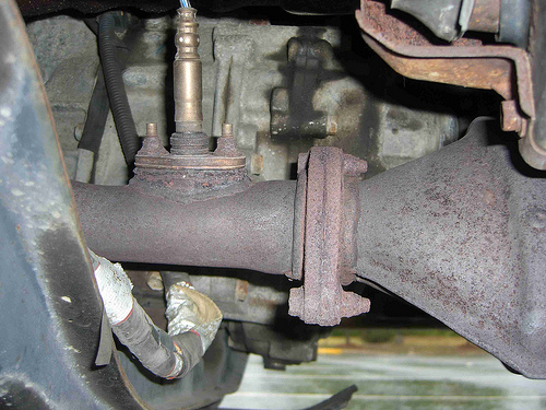

I know this isnt really for helping me, but I'd like to see if thats my problem. I just have a noob question... Where's the o2 sensor and how do I check it?

dont quote me on it...
but if you follow the exhaust manifold down, before you reach the next thing on the pipe (i think its called the catalytic inverter) it should be on the upper side. i beleive its a 3/8 socket.
knocking in engine with acceleration - any advice greatly apprecaited-4997333249_73a496e3a4.jpg
should look like this...(pic belongs to irab88)

should be somehwere befor the cat, and its should be flanged, and have 2 10mm nuts holding it on
