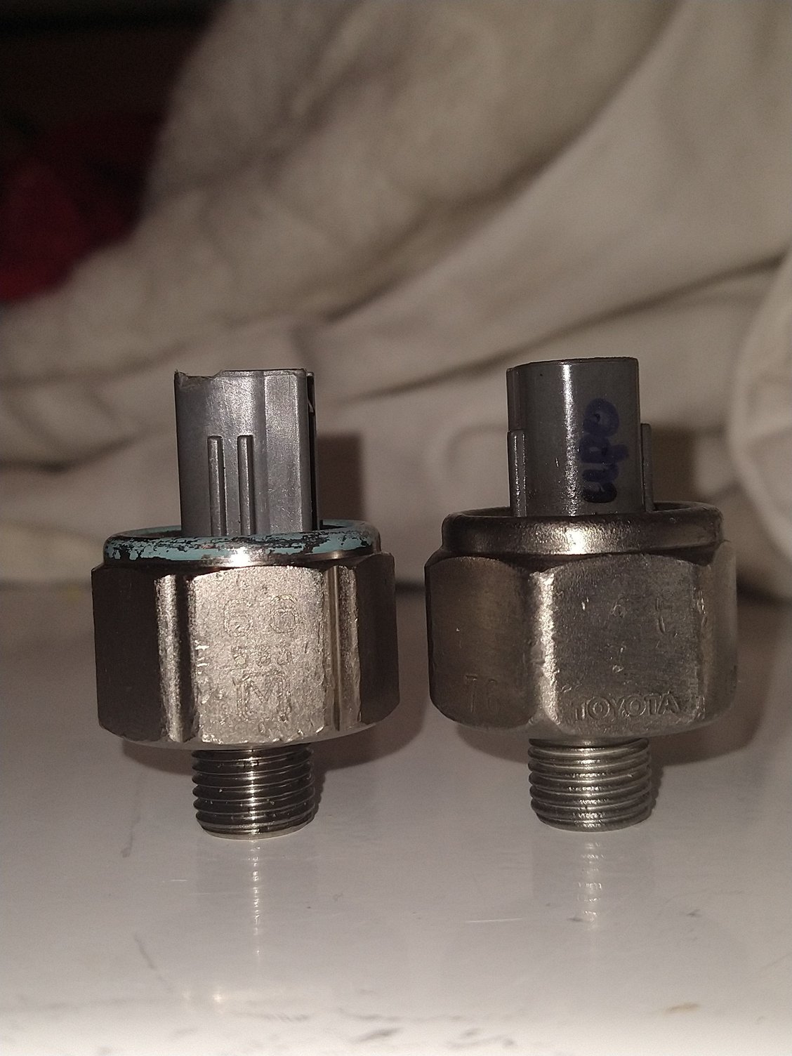

Well at this point I'm pretty damn sure the eBay seller sent me the wrong part, on the left we have the sensor that came out of my 3.0, as you can see, it's got a blue ring around it and has an M stamped on it, which I didn't know this but Matsu˟˟˟˟a, the same guys who manufacture cassette deck motors, also happened to manufacture Toyotas knock sensor a during this era of 4runners
The sensor on the right says Toyota but does not go to our 4runners, this one I'm pretty damn sure fits the 3rd gen models that have a 3.4L in them, and as far as I know, those ones have two knock sensors,
My part #: 89615-50010
Most likely the part number for this:89615-12040
So I'm hoping the eBay seller will make this right and send me the right sensor or I'll have to return this, which really upsets me because I'm actually fixing this for my wife and was trying to finish it before Christmas

Matsus.hita(Panasonic), along with Tokarika is/was a vendor of electronics that Toyota used heavily.
This may be way off base, but the one on the left looks more OEM legit than the one on the right. The stamped "Toyota" just doesn't seem right. But I could very well be wrong.
Not crazy about using a used knock sensor, regardless of who made it, on a 3vze; but as far as Matsus.hita is concerned they made great parts.

The one on the right looks like the one on my 86 22RE truck. Toyota 89615-50010 Knock Control Sensor

So should I throw it in? That part # matches exactly my car, and although they look different, I guess if the part number matches, then there should be no problem right?
