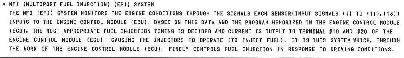

Notice the ECU only outputs the ground for the fuel injectors on pin 10, or pin 20. Pin 10 is even, 20 is odd. They are provided +12 at all times, so when 10 applies ground to the injectors, yes, ALL the even numbered injectors fire.
Does that help?
Pat☺
