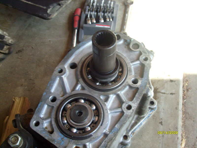

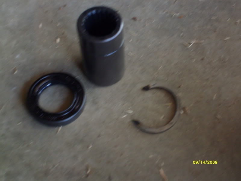

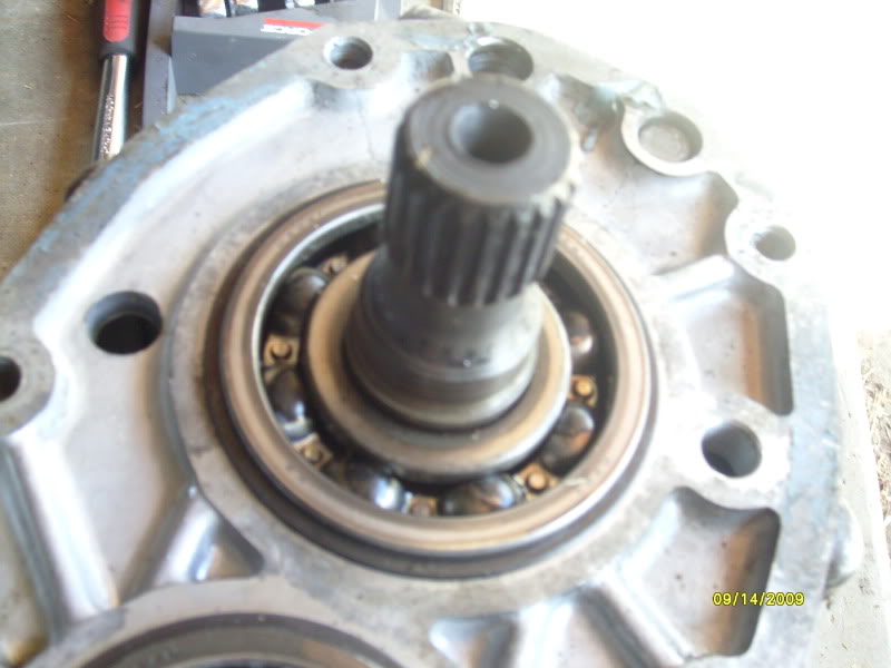

it sounds like you have decided to just pulled the shaft but I thought I would post some pics for motivation, here is what happened when i was too lazy to pull the rear d/s after a day of wet wheeling
not supposed to see the spline coupler from the transmission when you pulled the T/C

crappy pic but you can see the bearings have been roasted
Originally Posted by dropzone
Finally got the transfer case apart. Looks like the thing kicked into low range and fried the bearings on the input shaft, no thrust bearings left
If I have to flat tow again I don't care how crappy the weather is I will crawl under and drop the driveshaft
hopefully get the PITA back on the road this monday or tuesday
