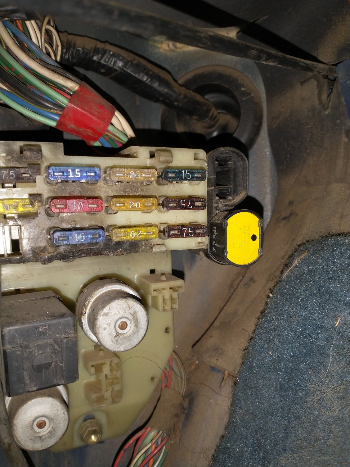

Something tells me these scorch marks could have something to do with it? Although I'm not sure if they were there when I bought it or not. Fuses are intact, or at least appear to be... any suggestions on what to do about this?

first, although you can generally see when a fuse has blown, the proper way to determine whether it is any good is to use your multimeter. second, you might want to take a look at the ratings of the fuses called for in that fuse block. i see too many 20 amp fuses. most should be 15. don't believe there should be any 25 rated, either.
Found some photos of the kick panel diagram, looks like everything should be a 15 except for the two 7.5s (saw one that had a 20 for the defog instead, might be a different year?).
Will replace those and at least if they start blowing I'll have a trail to follow. I'm sure the PO replaced them because they kept blowing (anything he did seems pretty poor work).

the plastic cover over the fuse panel should list the proper ratings for the fuses
