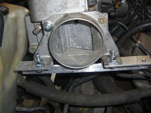

how is your air filter mounted to the afm? the only filters i can find are circular openings vs the rectangular bolt pattern on the air box side of the afm.

the stock supra afm has a 3" pipe-to-flange plate already, and i'm pretty sure you can find one that'll fit at the junkyard

ah, thank you that helps alot, i figure ill try to make one. What configuration of silicone bends did you end up using? Did you notice your idle drop at all after this? I just replaced the stock air box and afm with a cressida afm (swapped the circuit boards) and generic pod filter in the stock location on the driver side. now it seems like its idling a little low making the whole truck shake quite a bit. Thanks in advance! your thread has been very helpful.

make sure you don't have any vacuum leaks, and that the afm circuit tests correctly (acording to the fsm). then, iff those test out good, adjust the idle screw to get a good, smooth idle.
i do not know what your engine bay looks like. there are many different variations of air-conditioning configurations, throttle body angles, and accessories that will determine what shape of intake you have. go ahead and post up a pic of the area where you want to route the intake.
