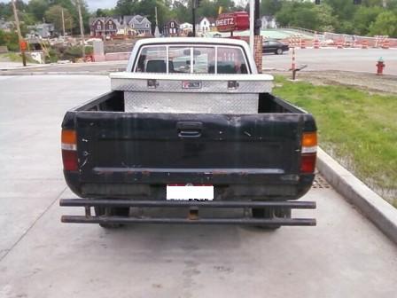

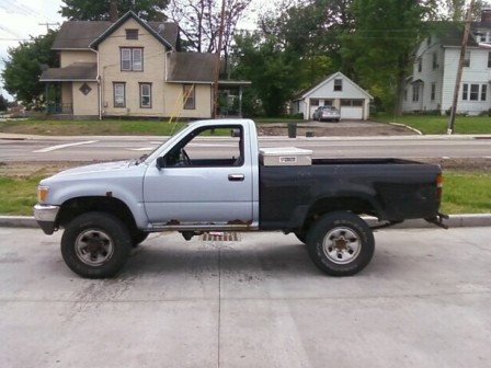

Update w/pics
I justed wanted to post some pics up.........I call it the bruiser . I plan on painting it all black this summer. Along with bondo on the few rust spots like under the doors and 1 small hole on each fender. And im gonna paint the frame to prevent rust (gotta love Ohio winters!).
Attached Thumbnails Introduction, Need advice and help-yota.jpg   Introduction, Need advice and help-sideview.jpg   Introduction, Need advice and help-rear.jpg
