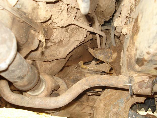

well...heres a picture or two...
one of them you can see where the swaybar was rubbin the driveshaft...the other you can see the broken mount...

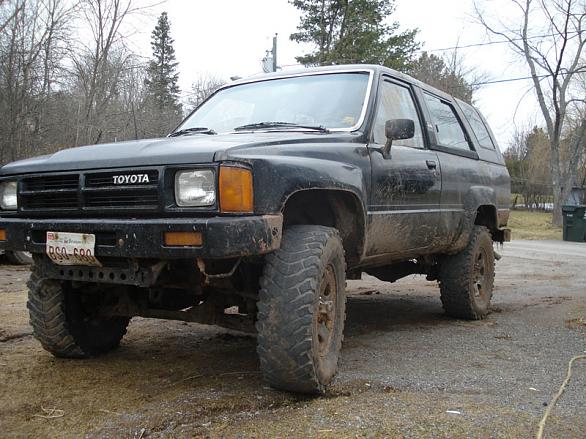

though i'd throw in a pic of the truck as wel ( bad one i'll take better later )
EDIT: i'll be building the new mounts tomorrow, and having a friends old man weld them in, as i'd rather not do it myself and have to fix it twice!
