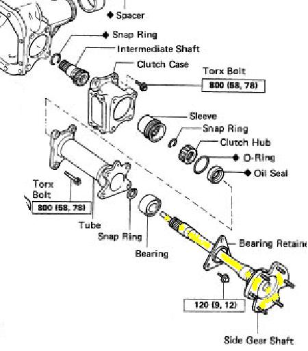

You mean the side shaft? (yellow in this diagram)
Do you have ADD or no?
Someone doing SAS should have one laying around. Check over in the Classifeds.

Yes, I mean the side shaft. The FSM calls it the 'side gear shaft'. I always knew it as the stub shaft.
The problem I've run into is that the previous owner never used the 4 wheel drive mode, so the oil and grease didn't get splashed on the parts inside the diff. As a result, condensation which formed inside the diff has caused rust pitting on the surface where the oil seal rides which is causing it to leak.
The dealer wants $320 for a new shaft. Not going to happen. What I'm doing now is I'm going to chuck the shaft up in my lathe and polish the seal surface to see if I can get it smooth enough to seal properly again.
As a fallback position, I'm hoping that someone who's done an SAS will have an old shaft laying around they might want to get rid of.
