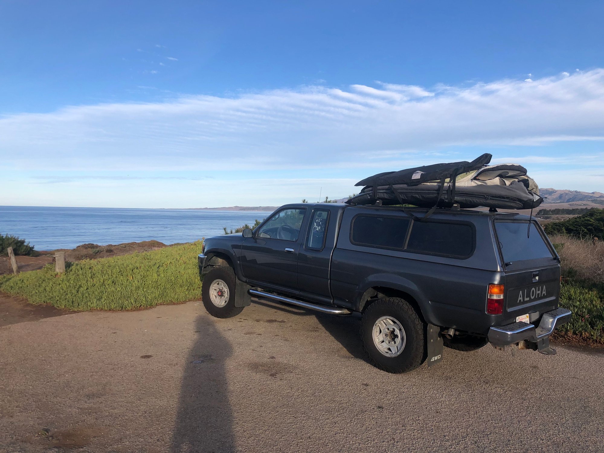

Hey everyone been a lurker ever since I picked up my baby and have been trying to learn as much as I can about fixing it myself because I am a broke 20 year old college student! yay me. Anyways the issue I am having it that when driving and released from being on load (in gear), it will drop to a low idle and bounce, stumble and almost want to die around 250-500 rpm than after about 5 seconds it will return or find its normal idle at 850 rpm and run fine. While it is doing this for about 5 seconds during that time period I can blip the throttle once or a couple of times and it will return to its normal idle without having to wait the rest of the 5 seconds. When I start the engine when it is cold it idles fine and drives fine until it reaches operating temp. Also occasionally not all the time when I start the car when warm it does this as well where it will idle and bounce around 250-500 rpm. Anyones input is really appreciated, I've been scouring the forums and have read some threads, I just cleaned my throttle body and the air valve and tried my best at checking the tps with a multimeter and feeler gauges (it looked fine) as well as checked for vacuum leaks. and the problem still exists. So if any one could point me in the right direction or tell some things to check that would be great thanks!
oh and its a 1992 pickup 3vze v6 4x4
