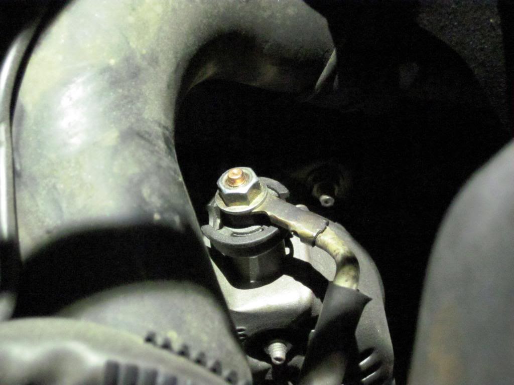

QUICK and SIMPLE CHECK THAT I don't Think You've Done Yet.
QUICK, SIMPLE AND IMPORTANT CHECK that I don't Think you've done yet.
With all circuits off, disconnect "B" Wire from the alt output screw terminal (shown below).
Measure resistance between that screw terminal and ground. It should be in multiples of mega-ohms. Let us know what you get.
Old Mar 3, 2017 | 12:24 PM
  #29
_RaStA_RoCkEt_'s Avatar
Joined: Mar 2007
Posts: 210
From: Santa Cruz, CA
Thanks SO much for coming back and aiding me, man. I really appreciate it. I don't mean to have been a fool, but feel I was.
I'll get right on this when I get home.
