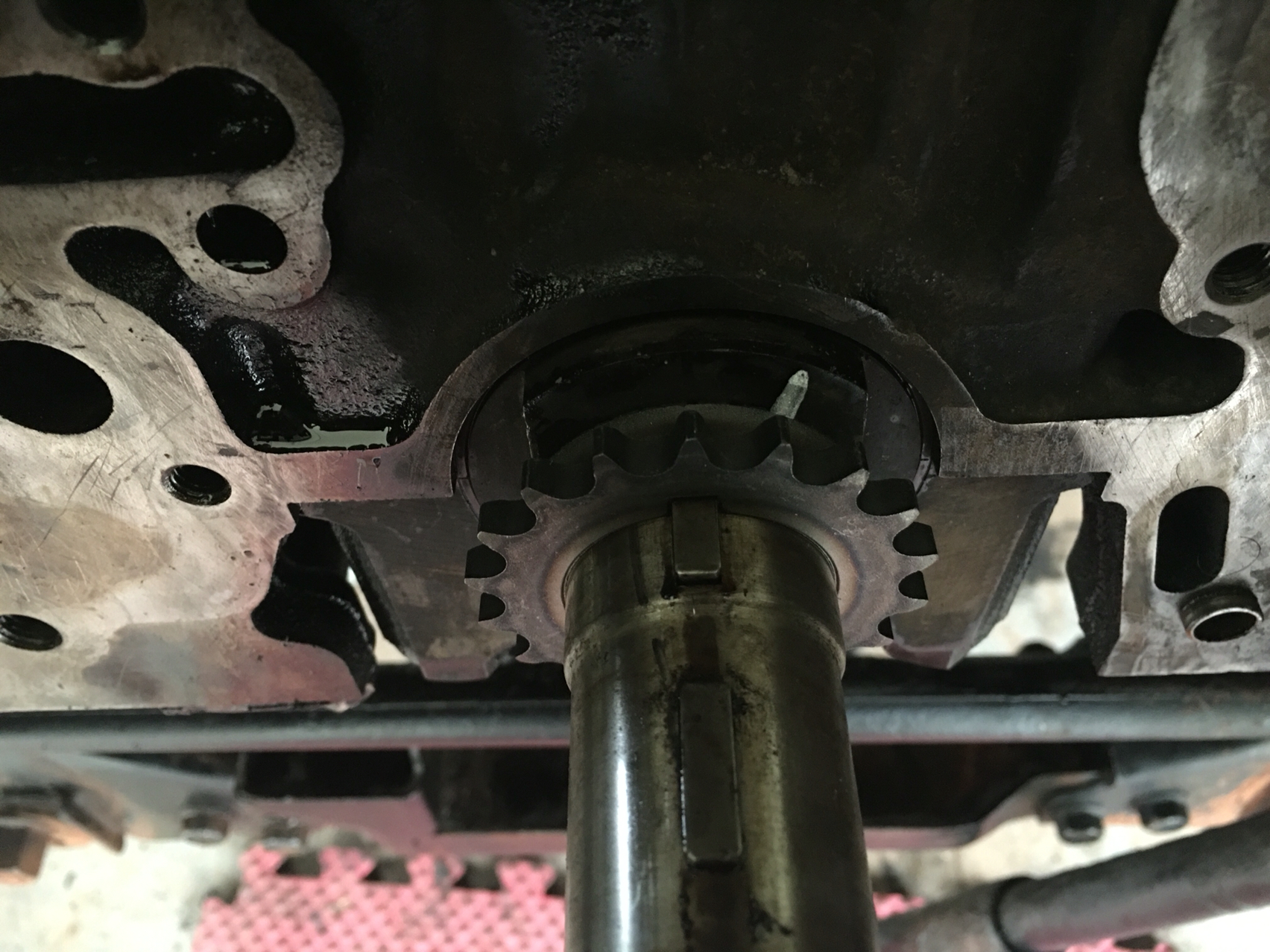

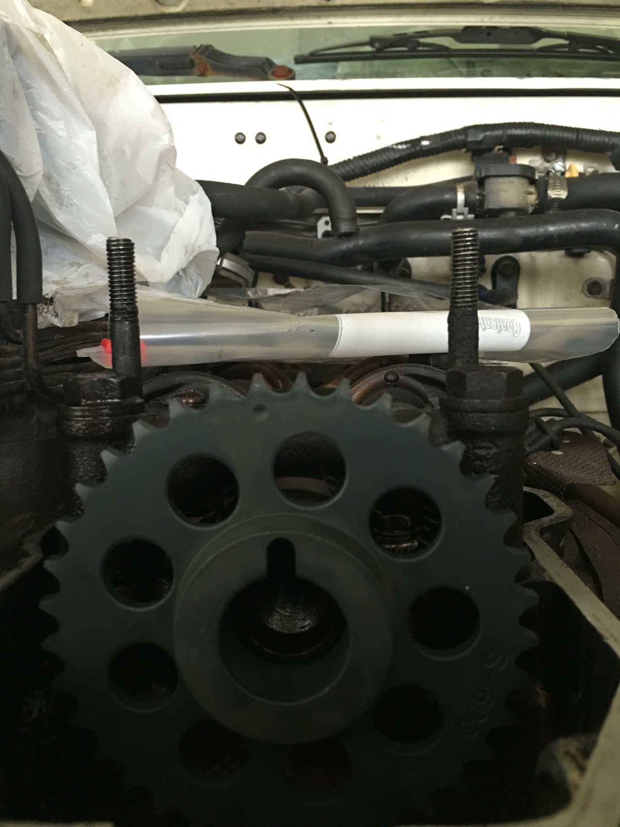

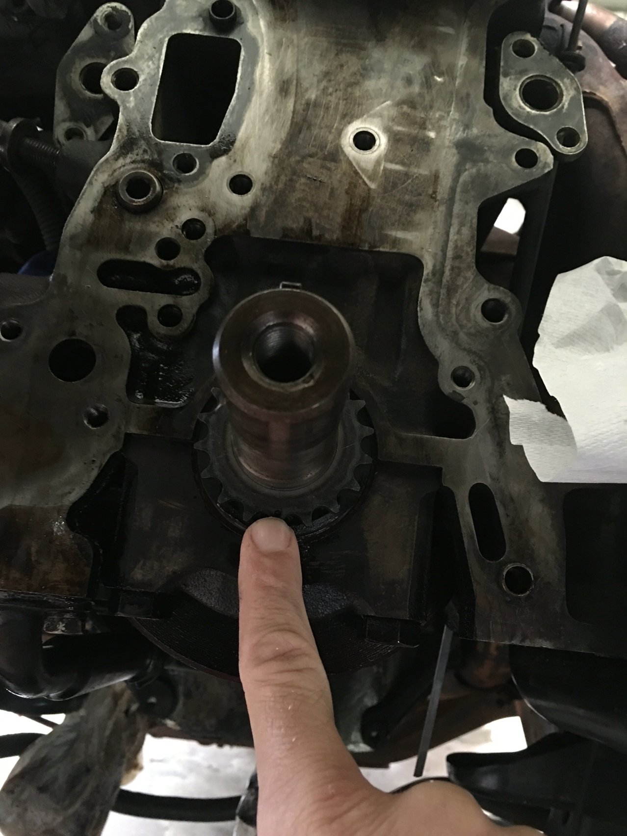

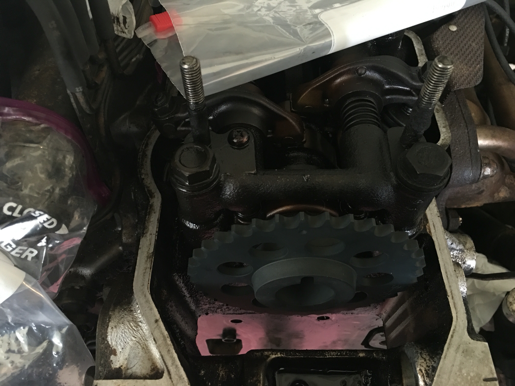

Here's an update of where I'm at. These are some pics of what my sprockets look like before the timing chain is put. Kinda a dry fit with my new sprocket.
