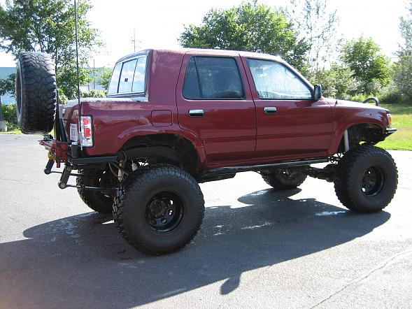

yes, I have thought that through pretty well. I currently own a 2000 f250 w/ the 7.3 and I love it. Lightly modded just enough to have fun with. Great pulling rig. I pull my rig and a buddy's jeep on my 36ft gooseneck and runs down highway real nice.
Only reason I"m not going w/ the psd, is because of weight. Granted I guess we're only talking about another 300lbs over the v10. However, personally I feel that the stock v10 would better suite my horsepower/torque needs. I'd have to juice up the psd a bit to satisfy my hp worm. The stock v10 gives you well over 300hp right out of the gate. I think the 6sp would be nice (and alot more fun to drive) but after having experience at serious rockcrawling with a manual and an auto, the auto is pants down the ticket for me.
It'll be a fun build. I hope to begin later this year and do a winter build. Gonna give the original yota one last season
