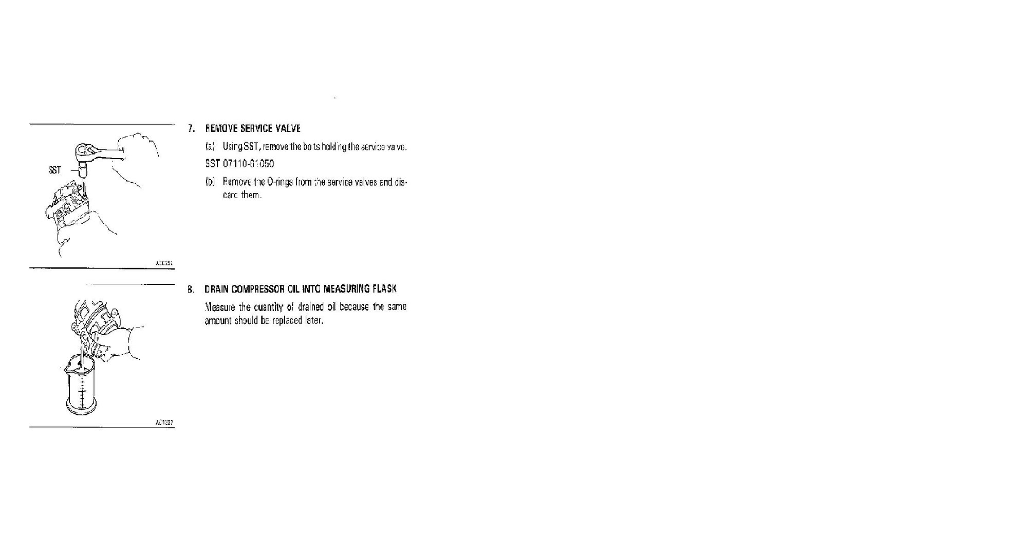

I saved the Toyota TSB on AC conversion another member posted a couple months ago. (PDF file below the image on draining oil.) The kit with fittings and orings are still available from Toyota
Below from '88 FSM on draining oil from compressor.

Great - so yes, have to remove and replace the compressor.
