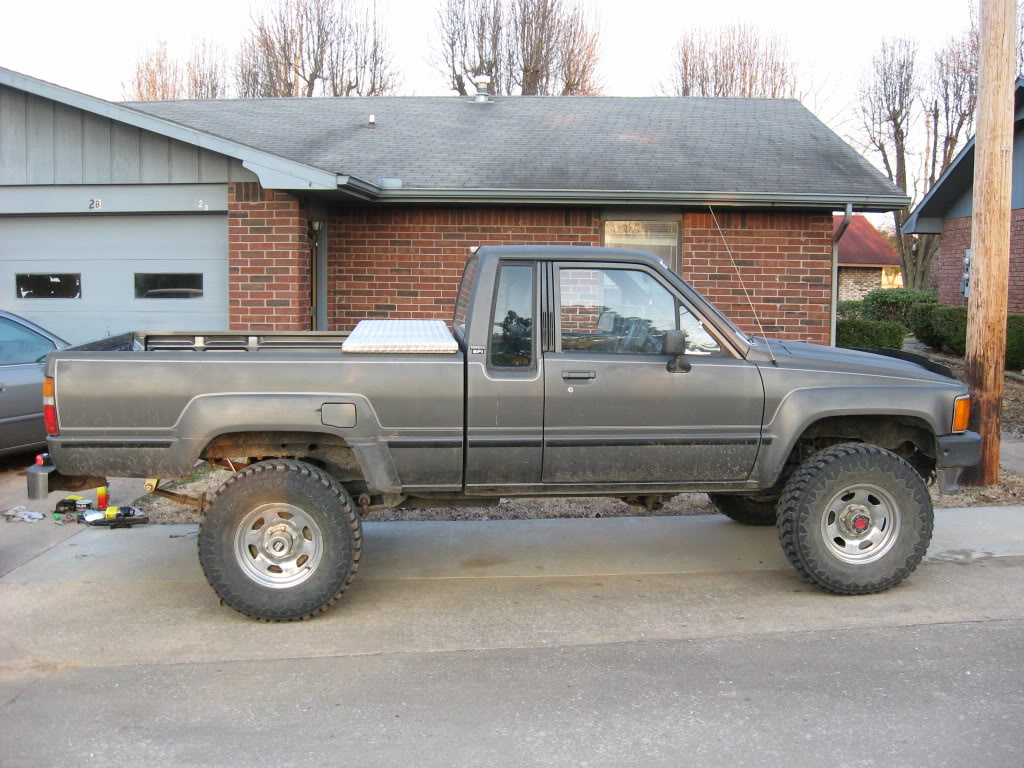

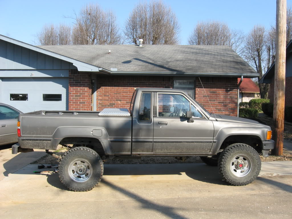

Ok, lets start with the 'ol before shot. For reference, those are 31" Hankooks:

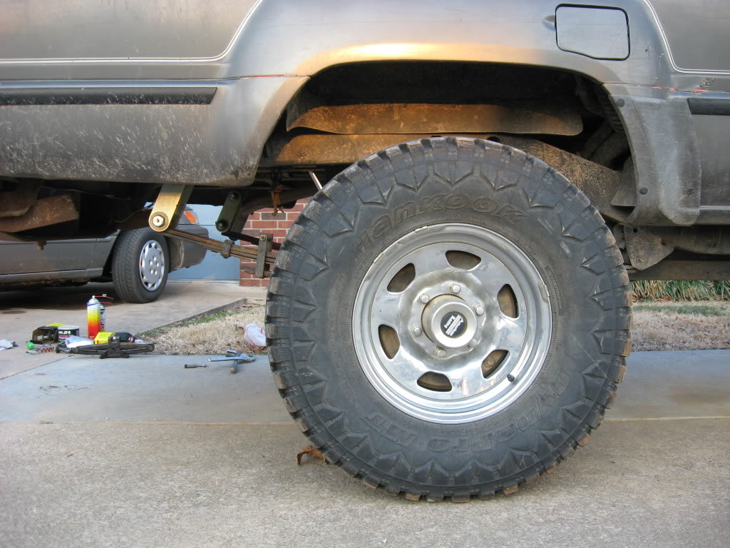

Alright, now to the nitty gritty, to make life easier, lower the spare tire and get
it out of there. I can sit upright comfortably under the bed doing this, nice! Spray
your shackle bolts with a pentrating oil in advance if they look like they will be
trouble. You will notice in this picture that it does not appear that my shackle
bolts are centered in the leaf spring eye or shackle mount. This is a very good
indication that the bushings are completely worn out and possibly gone:

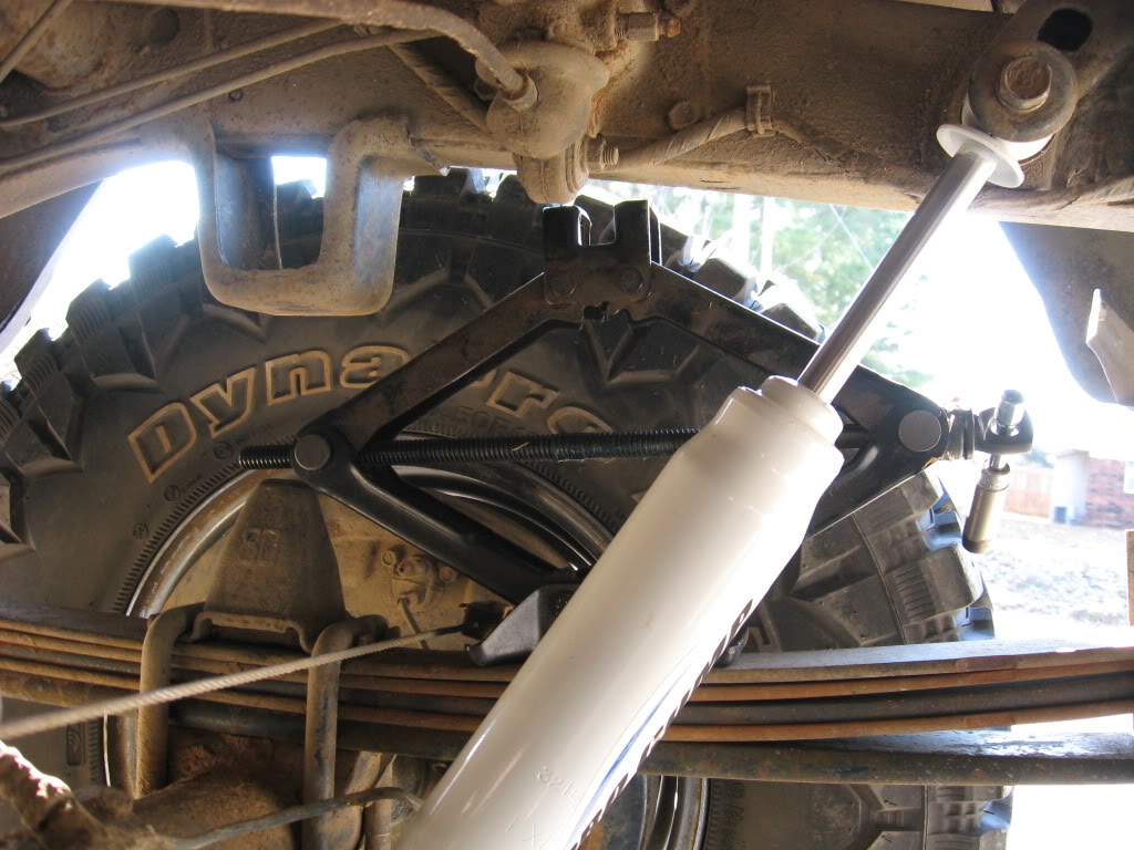

Next, get a car jack, I'm using a scissor jack out of my camry and slide it onto the
leafspring, getting as close to the axle as possible:
Once, you get it positioned, raise the jack up slowly, all the while keeping an eye
on the shackles. You will have to go a little ways but you will soon see the shackle
begin to relax and you will be able to wiggle it with you hand:

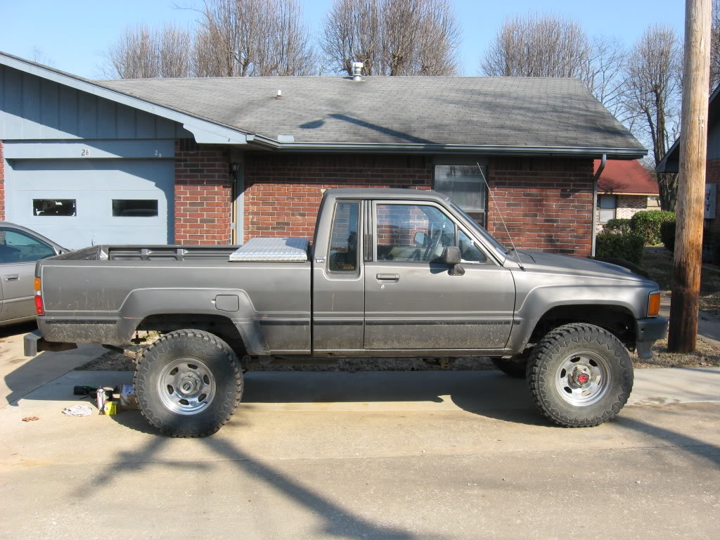

Now, just for fun, hop out from under to see what your truck would look like with a
3" lift:

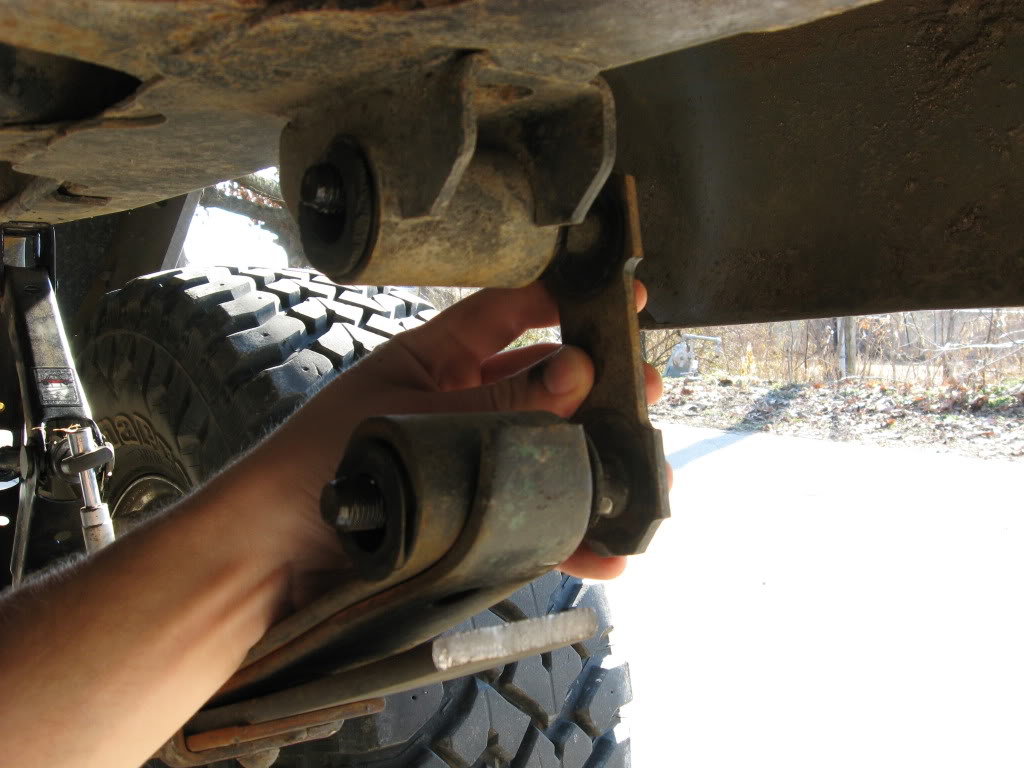

Alright, now for the carnage shots. Here you can see that all of my original rubber
bushings are destroyed. You can also see the shackles have been considerably worn.
Of particular note is the shackle bolt on the left of the picture. You can see that
due to the metal to metal contact it has had for the past who knows how many years,
about an 1/8" of material has been worn away:

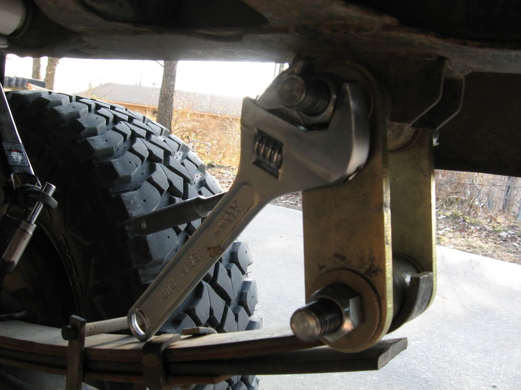

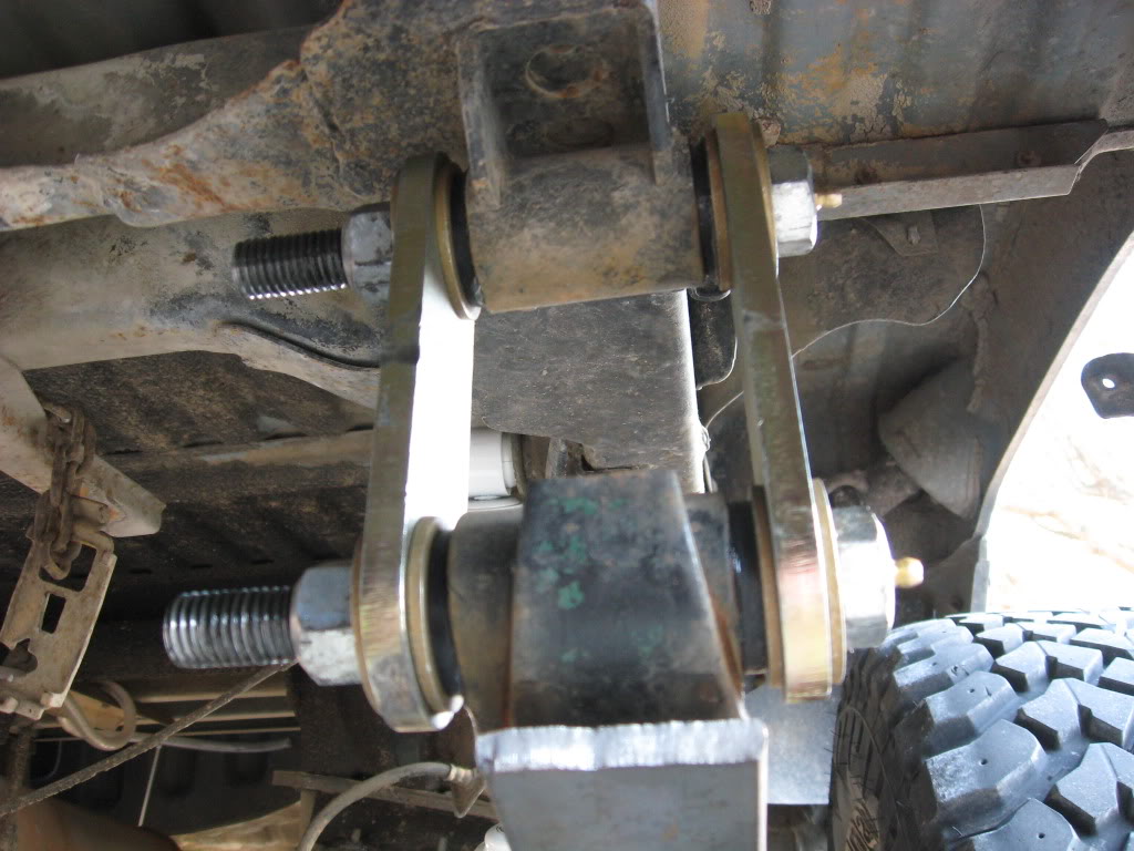

And, pull them back off and grease all surfaces, including the leaf springs eye and
shackle mount and put it back together. Then, start tightening the nuts down. With
Trail Gears castle nuts, they recommend putting anti-seize on the threads before
putting them on. This type of locking nut doesn't hand tighten! I wedged my crescent
on nut and the leafspring, and tightened the other side with my breaker bar and 27mm
socket:
Be careful not to over tighten these nuts as you will compress the bushings and they
will not turn easily. Ok, and here is the final product. Like I said earlier, these
bolts were actually designed for a wider spring so there is a fair amount of extra
thread, but it ain't hurtin anything:

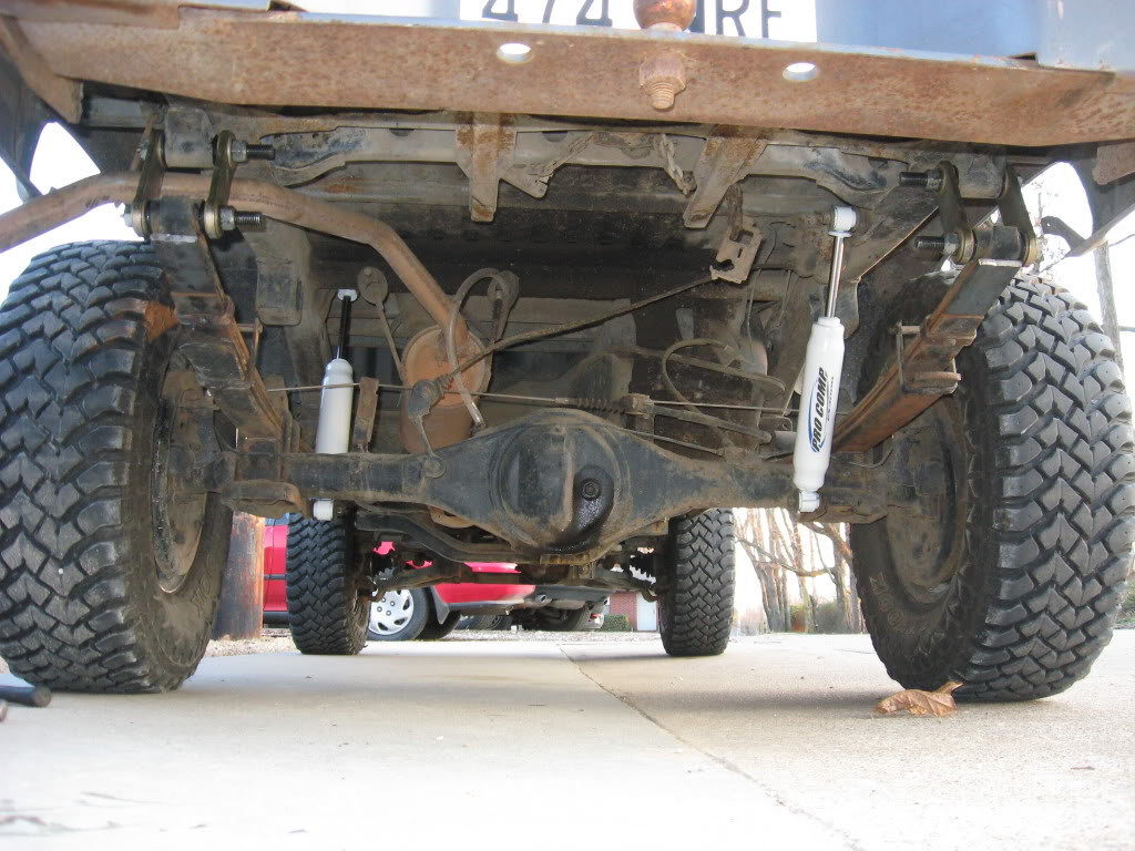

Now, lower the jack slowly, rinse and repeat on the other side, and you are done!
Well, unless you want to pump the grease zerks right away! Here it is from behind
and under:

And finally, the overall sideview:
