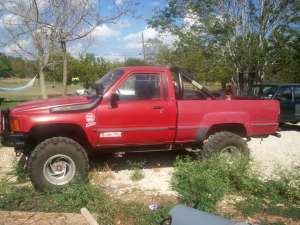

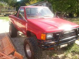

I got a 1987 4X4 Im going to try to buy but wanted to know what it costs (est) to rebuild the carb on the truck. I havent called the guy since its late but in the ad the truck has been sitting a while. What other issues should I look for in that sort of truck? Hes asking $1500. I got pics attached
a carb rebuild from a reputable shop can run anywhere from $150 to $400 depending on where you go and how bad of shape the carb is in. you could also replace it with an aftermarket carburetor like a weber or 2bbl holley.
Ok talked to the guy and dont know what to make of this truck. Body/frame has 375k on it (not a typo) and the new motor has 175k on it. dont know if thats too much of a project truck for a novice like me.
