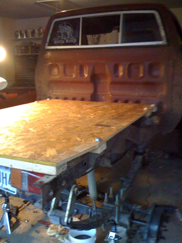

If any of yall have ever wanted to build a flatbed for your trail beater or firewood getter, but haven't gotten around to it because you figured it'd cost too much or you don't have the fabbing skills? Well my friends, fear no more. If you have $30, can use a wood saw and turn a wrench, you can do it!
Materials:
1 x piece of 4'x8' plywood ($10) You can use any thickness. I used 19/32" thick.
1 x piece of 16' long 2x4 ($5)
8 x hex bolts measuring 5/8"x3" ($5)
8 x 5/8" hex nuts ($1.50)
8 x 5/8"x1.5" washers ($1.50)
1 x 5/8" wood bore drill bit ($4)
Under $30 with tax.
At this point, I'll be assuming you already have the bed off. From here it's just 6 simple steps.
Steps:
1.) Cut down your 2x4 into 3 pieces that are 3'9.5" (45.5") long, and 1 piece that's 3'5.25" (41.25") long.
2a.) Lay the 2x4 down horizontally over the body mounts, and the shorter one 9" further back from your last body mount.
2b.) Mark the location of the of the pre-existing holes onto your 2x4s, and drill them out with the wood bore drill bit.
2c.) After you've drilled the 2x4s out, they should look something like this:
3.) Now cut your 4'x8' piece of plywood down to a length of 5'3.75" (63.75") and a width of 3'9.5" (45.5").
4a.) Next, lay your cut piece of plywood down onto your 4 pieces of 2x4s.
4b.) You'll want to make sure that all your edges and holes still line up. Do this by sticking a bolt through the bottom of the body mount into the 2x4 to keep it in place.
4c.) Mark the location of the holes with a pencil onto the bottom of the plywood by removing your bolt and sticking a pencil up through the body mount and 2x4s.
4d.) Take off your piece of plywood and drill out your holes with the wood bore drill bit.
5.) Place the plywood back on top of your 2x4s, drop your bolts down, and tighten up the nuts. You should be looking something like this by now:
6a.) At this point, you could be done, but I decided to trim a little off the rear corners to give it the illusion of being bob tailed (and so I wouldn't snag anything on the overhanging plywood).
6b.) To do this, draw a line from the end of the 2x4 at the bottom to the end of the 2x4 next up.
6c.) Now cut off the offending edge.
You're done! Go drink a beer, or hit the trails with your grainy new flatbed you built for under $30!

cool idea for the money....did you account for frame flex? just thinking the 2x4's might crack around the 5/8" holes...
Old Sep 17, 2008 | 05:43 PM
85toy's Avatar
Joined: Jul 2007
Posts: 1,116
From: Arnold California
lol do toyota frames even flex like more than 1/8 inch.

Hell, even if it does, it's just a 2x4 lol... Plus, if you wanted to go fancy, you could even go with treated wood! AND SPRAY PAINT!!!

Now Ford frames on the other hand, would flex so much they could crack/ tear split a rubber bed.
I was behind a ford on a trail once and the frame was moving a good 10" relative to the body.

Eh, I really aint too worried about frame flex. If it happens, then i'll figure something else out. Maybe rubber bushing in between.
And man, I swear chevys are the worst at crab walkin... I see them all the time! Gotta love boxed frames.
