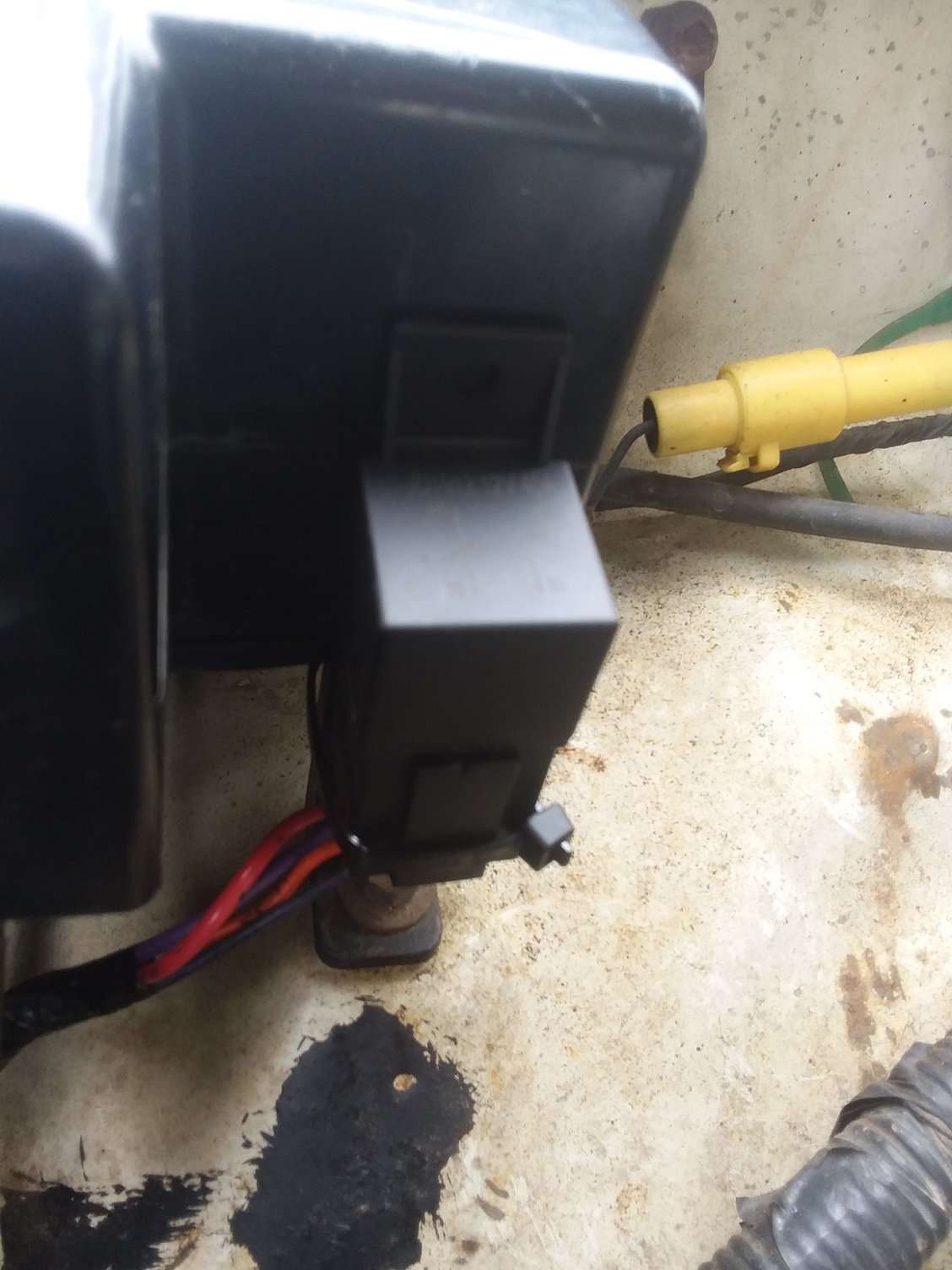

Hey I finnely got the duel horns installed and rewired the original horn for a toggle switch. I found this old relay plug that came out of something from a Jeep Cherokee I used to own. Great right up! Thanks.
