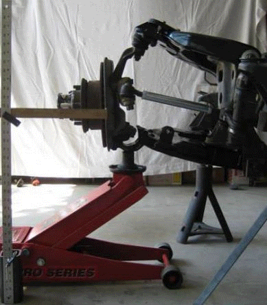

Pics, need pics! Thats what I keep hearing. Anyway, I would be willing to bet you will spend at least a $ 1,000 in parts and materials. Then factor in your home labor time of say 40 hrs x $20 = $800, conservative I know!. You would be doing well if thats it. My kit cost $775 in base form.
"Home made long travel" is what should be discussed in this forum thread. My stuff started as home made but progressed, so I can relate.
Ditching the front diff and CVs will give you a lot more freedom. Using hiems will be strong and with various missalignment spacers and careful planning more range. Depending on how wide you go (say around 3-4" per side so it stays relatively street legal) you should be able to get 13-14" of travel. I found that a frame section of the front end is helpful and you won't destroy your truck with modifications and mistakes. Plus you can still drive your truck till you get your design finalized.

Originally Posted by BlazeN8
Then view through quickly, clicking each one in a loop and you can see the range.
