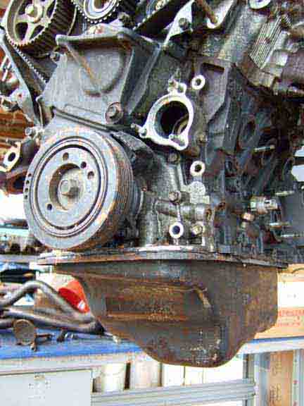

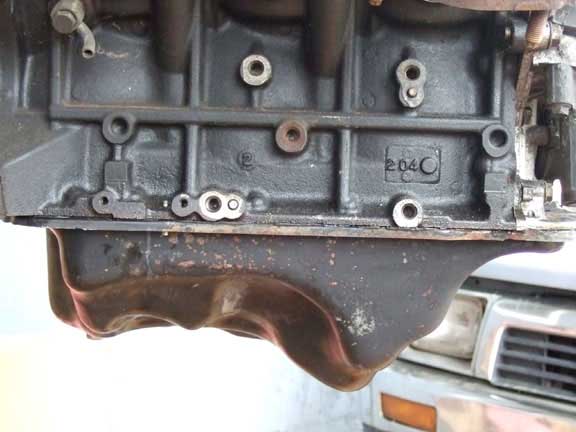

Latest,
Finally got my 3VZE oil pan back from the engine wash and installed it on the 3VZ-FE. Its a perfect fit. The trick will be modifying or building an oil pickup for the 3VZ-FE that will fit the 3VZE pan. The 3VZE has a lower profile pan in order to clear the steering rods and transfer case and a oil pump inlet to allow for clearance here (All of which the 3VZ-FE does not have to worry about) Perhaps using the oil pump from a 5VZ-FE 4X4 would work? Anybody know here. If not I'll just build one to work.

Ok all,
The weather finally let me work in above freezing temps. I got the 3VZ-FE installed to where I can figure out the motor mounts. A couple of things to note here is that The 3VZE 4X4 oil pan will work. The oil pick up will have to be modified as mentioned before but thats ok. The oil filter mount will have to be modified to a remote or an aluminum adapter will have to be fabbed. There is room for this so maybe this is how I will go. Oil pressure sender will have be relocated and mounts will have to allow for dipstick to still work.
