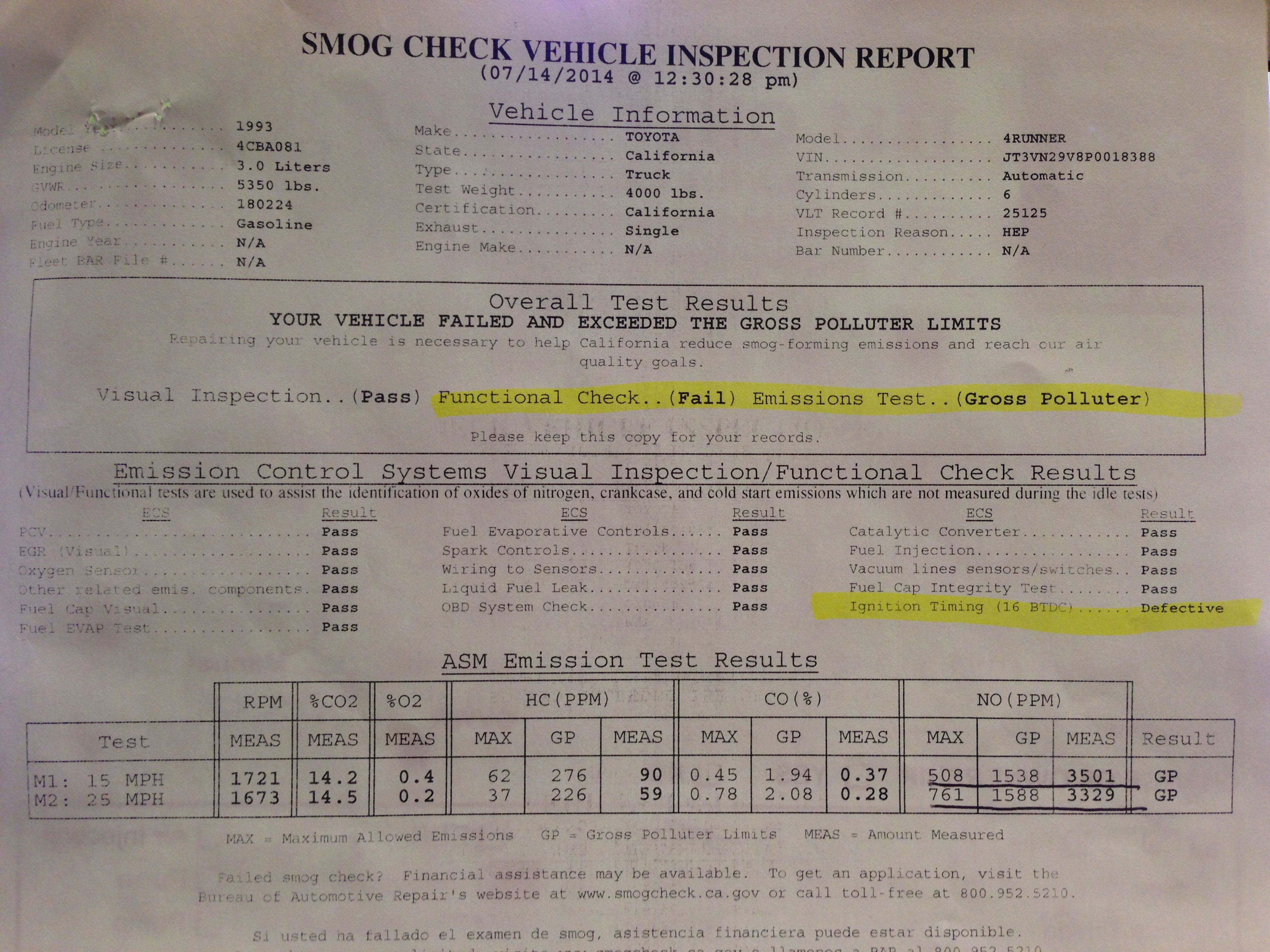

For the record:
1993 4runner 3VZE 6.0 w/ 180k miles
First time (about 2 months ago) I took her to get smogged, the guy wouldn't even run it (audible misfire, so he knew it wouldn't pass). Have put some work into the ol' girl since then (including all new injectors - Flamthrower's - new TPS, new FPR VSV, plugs, wires, dist cap and rotor, etc.).
Finally went in for second attempt at test. Everything checked out, so the truck was run. All inspection components checked out except for timing (16 degrees BTDC). *Didn't notice I didn't have the EGR temp sensor...whatever.
FAILED! CO% is within range. HC (PPM) and NO (PPM) are both too high.
I've gone through this engine and done everything I can find, checked everything (including EGR) I can get to, and she's running really well (well, not according to CA's BS rules) - passing all FSM checks, minus my needing to replace the EGR temp sensor.
I'm attaching a pic of the smog report. I'm going to go back through and check everything exhaust/emissions related, per the FSM...but in the meantime, can any of you smog/emissions geniuses take a look at the numbers and tell me if anything jumps out at you as a "for sure it will be (blank)."?
For whatever it's worth, the tech said my timing being at 16 degrees should have actually helped me (but it didn't). If my numbers had been within range, he would have just entered 10 degrees and passed me, but since the numbers were so far off, he just recorded the actual timing. Based on his statement, putting timing back to 10 degrees will actually make my numbers worse? Will it make my CO increase too?
Also, I have the silicone from the VAFM cover already out (from a recent fix)...the "clicker" is where it was when I took the top off...if adjusting the VAFM a click or two either way will help me pass, I can do that with relative ease (but I'll need to silicone it back together before the retest, since the guy said he wouldn't make a big deal about it today but wants to see it sealed up next time he sees me).
Additionally, could the misfire condition (due to a faulty #5 injector, which has been fixed) that had been going on for who knows how long before I bought the 'runner have caused the CAT to clog, thus ruining what appears (cosmetically) to be a relatively new CAT?
Finally...since the FSM doesn't say anything about checking the CAT (just how to replace it), is there any truth/validity to doing a heat and/or pressure test (comparing pre and post cat numbers), running lacquer thinner through the tank, and/or physically cleaning the cat using liquid laundry detergent?

Your HC is high, but your NOx is over the moon! I assume you have the temp sensor replaced with a resistor or something to suppress the CEL. Which means you're now flying blind.
The purpose of the EGR is to limit NOx. That's what it does. That's all it does. The temp sensor checks that the EGR is working. Without the temp sensor, you didn't know that your EGR is NOT working. If it were me, I'd run the FSM diagnostics on the EGR. I'd add checking that the the passage into the plenum is not substantially blocked by "crud." Last, I'd fix the temp sensor so that I'd get the full benefit of the ECU's brilliance, and not have to wait for a smog tech to tell me what I should have already known.

Your tech is a little off I think. Timing too advanced causes high NOx but NOT high HC. My thinking is you're too advanced AND you're running lean.
Lean could cause high NOx and high HC with CO and CO2 fairly normal.
Not sure how Cali works but here in CO we get a free attempt after a fail. I'd get that timing correct and replace the O2 since you're probably due for it (Denso ONLY plus it's cheaper like 50 bucks or so) then run her through.

This site http://www.autoshop101.com/forms/h56.pdf has a good tutorial on emissions analysis. Based on that article and your low O2 percentages, I don't think you're too lean (too lean will cause high NOx, but not the high HC ... at least until you're so lean that you're misfiring).

Unfortunately, here in CA, they only allow +/- 3 degrees from the manufacturer's recommendation, so I have to at least be close to the 10 degrees BTDC. I'll be adjusting the timing to the stock setting and hoping it makes the truck run better, not worse.

The ECU possibly knows more about this problem than you are finding out from it so far. You need to make some measurements on the diagnostic port with your multimeter. Do the following and report back with results.
1) First, warm up the engine as you did before your test.
2) Put a multimeter from pin VF1 to E1. Measure the voltage at idle and at 2500 rpm. It should be between 1 and 4 volts. If it's stuck at 0 or stuck at 5V your emission control loop stuck to one side.
3) Shut off the engine, short TE1 to E1, restart the engine, and make the same measurments. (VF1 to E1). If your control loop is working properly and the O2 sensor is healthy, that voltage should cycle between 0 and 5 volts slightly slower than once/second. This will be a bit hard to see on a digital meter, but again, you should be able to tell if it's moving or if the voltage is stuck at 0V or 5V. This voltage is the conditioned O2 sensor output.
If both of these tests check out, and you're sure your EGR system is healthy, then it's likely that your cat converter is bad.
Just to repeat some quick theory on this:
- The cat converter only works effectively to minimize HC, CO, and NO when the air-fuel mixture is stochiometric (~14:1)
- The O2 sensor gives a binary output that tells the ECU whether the mixture is rich or lean, but doesn't tell it by how much.
- The ECU adjusts mixture until it gets an equal number of "lean" and "rich" outputs from the O2 sensor. That tells it the mixture is balanced between rich and lean.
- The cat then does it's job and cleans up the remainder of the emissions.
- As a side operation, the EGR system reduces exhaust gas temperatures enough to eliminate most of the NO production, so that the cat can handle the rest.

The tests Ron (RJR) describes are good to do, because they are EASY. But I don't think your problem lies there. Having 0 or 5v are the limits of learned fuel trim, but both are valid and your truck should pass smog with either one. If 0 or 5v is not enough to stabilize the O2 sensor, that should throw a code (25 or 26). Similarly, if the O2 sensor is not flipping "about" 8 times in 10 seconds, that too should throw a code. And you don't have codes.
But, because your EGR temp sensor has been disabled, your ECU has been "fooled" into thinking the EGR is working Which you have confirmed is probably not true!
The good news is that according to this page http://personal.utulsa.edu/~nathan-b...77exhaustg.pdf , the VSV works (turning off the EGR) only when the coolant temperature is below 48°C. When the truck is warmed up, vacuum should be passed through the Q-to-EGR valve connection and start the EGR working. So if that hard pipe is blocked, your EGR isn't working, and it's no surprise your NOx is over the moon.
Of course, I would fix it. Some 18 gauge steel wire (any hay baling in your neighbor hood?) would be where I would start.
But, you can just hook the Q port directly to the EGR valve. Since the EGR will be "working" all the time, the engine will probably run poorly until warmed up. But once it's warmed up, I would guess you'll be good to go.
Can someone (anyone) confirm that I should NOT be able to pass air in either direction via the larger tube coming from the bottom of the EGR Vacuum Modulator? I believe it's been referred to in threads as the "backpressure tube" and allegedly there's a diaphragm in this thing that is supposed to prevent any air from actually moving through the modulator itself (any vacuum or air pressure is simply to move the diaphragm), and thus if air does pass all the way through said tube that means the diaphragm is blown out and thus the modulator is bad/needs replacing.
Do I have this all correct?
*If I am correct, I assume this "bad" EGR Vacuum Modulator would be a cause for my "over the moon" NO numbers during the smog test. Yes?
Join Date: Sep 2007
Location: San Francisco East Bay
Posts: 8,262
Received 825 Likes
on
652 Posts
I can't "confirm" anything, but here's http://www.autoshop101.com/forms/h61.pdf a better drawing of an EGR Modulator. It looks to me like you are correct; if you can blow air through the exhaust port on the bottom of the modulator, the diaphragm is toast and the modulator will be stuck at "I see very low exhaust pressure" all the time.
Since the purpose of the modulator is to provide more EGR during higher load, I would expect you are NOT getting enough EGR, and I would expect that to lead to high NOx numbers.
The good news is that a replacement part is only about $50 http://www.toyotapartsoverstock.com/...ssembly=487700 (RockAuto also has them, but oddly their price is only a little lower than this dealer). I can't say whether this will finally solve your problems, but everything points to a problem in the EGR system, and if you've confirmed a part is bad then I would definitely work in that direction.
