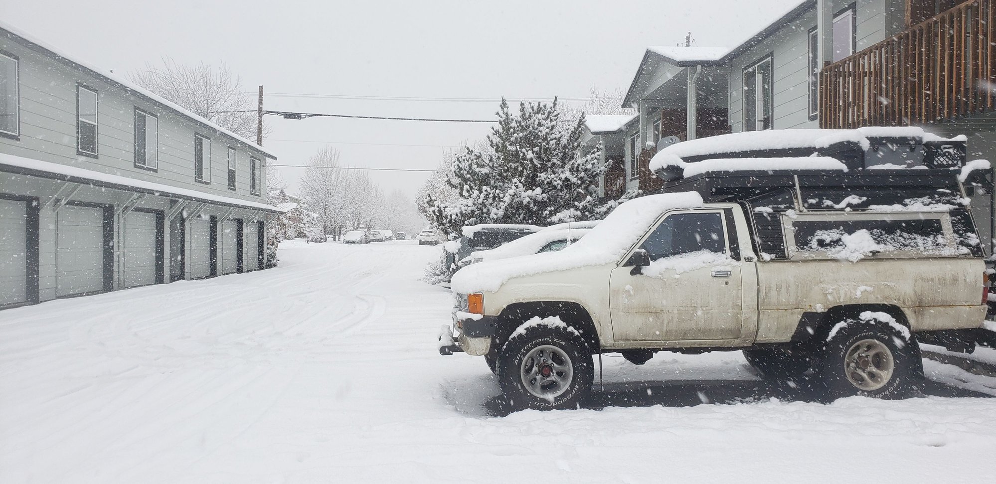

Meet Charlotte. Shes an 88, 5speed, 4wd, 22re. I'm mildly in love
She's charming but rough, like a funny vegas hooker. I've attached some pics to show that the previous owner (who didn't seem like a muppet) has done some work, but she's old, and could use some more TLC.
She seems to runs great, just 30 years behind the times. she's wet on the bottom, but doesn't seem to leak fast. She has ~215K in freedom lengths. I've had her about a year, and drove her up the pass all winter.
Recently she started making UFO noises after I put her back in 2WD for the spring, and I'm convinced its T-case ATM.
