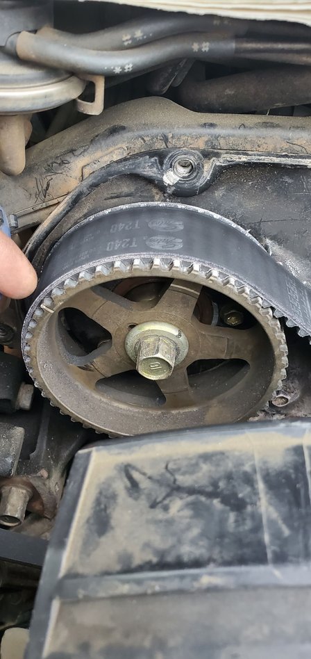

Today I pulled the timing cover off and noticed that when I rotate the crank to TDC, the left side cam mark is not lined up at the top, but the right side is. Not sure if this is a problem, but the Haynes manual says the timing marks should both align at the top when the crank is at TDC. Could this be the issue? The car ran fine for the 5k or so miles that I put on it which is what would confuse me if this was the issue.

Wow! It's hard to believe that truck ever ran with the valve timing off that far. Yes, the cam marks should always be together. At TDC, they marks should both be pointing straight up (or straight down; there are two TDCs). One sometimes hears of "jumping a tooth," which I believe should be impossible. Unless ... your tensioner has failed. Either way, you'll need to get that straightened away. Now would be a good time to replace the timing belt. (Removing and reinstalling the crank bolt (161 ft-lbs) is an issue for some. You could re-time the cams (and check the tensioner) without removing the crank bolt if you keep the same belt. Not what I would recommend.)

It's 100% not good to have the cams that far off. Word of advice, make sure after the belt is on that you tighten the bolt going through the tensioner, the spring alone isn't enough to hold it on and the tensioner does not float like some newer engines. Also, these engines don't have cam/crank position sensors as they don't have any sort of VVT and their form of fuel injection is fairly primitive.
