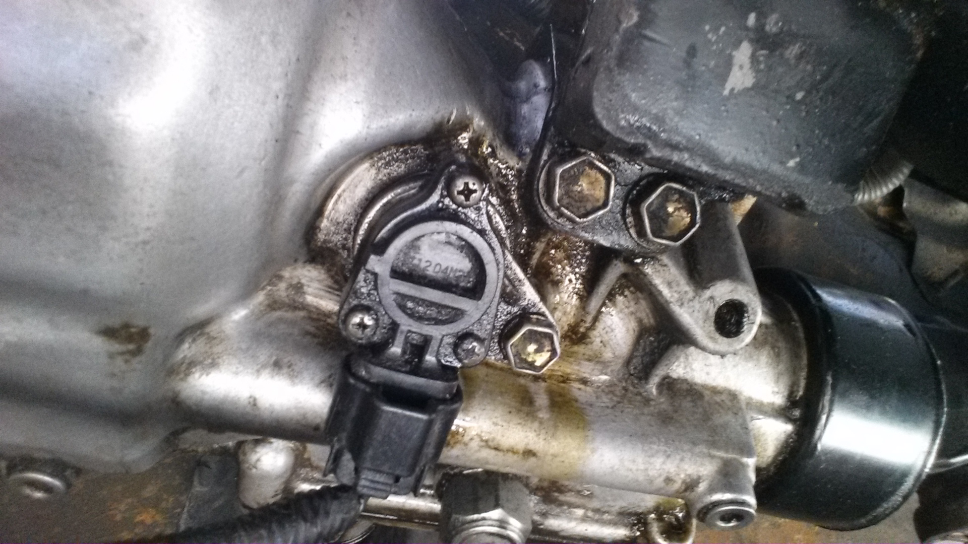

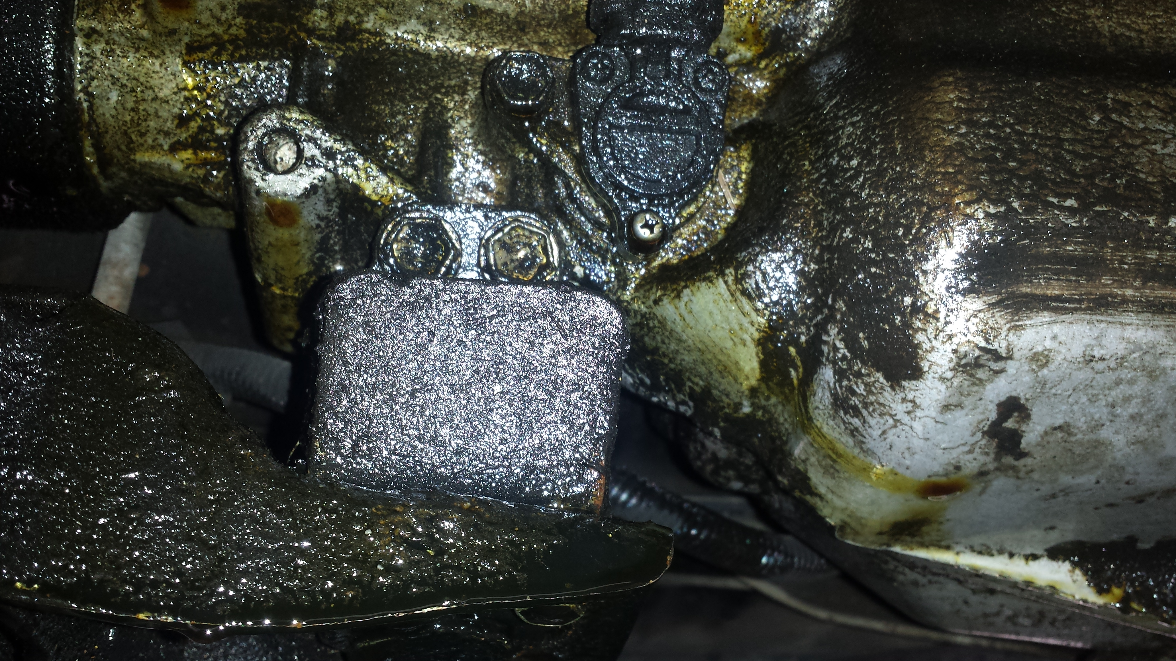

Hi all, new to this forum and looking for information on how to fix this transmission leak. I can smell the oil when I step out of the truck after driving and it looks as though its coming from the rear end of the transmission and driveshaft connection (see pics). Not 100% sure though and I am no expert on trannys...is there a seal here that could have gone bad and is it a somewhat easy fix? Is this a common problem? I drive a 92 toyota pickup 2wd with 109,000 22re. I believe the tranny is a w56, although I could be wrong there.

OK, thanks for the response. Will clean it up tonight when I get home from the gym and keep an eye out. Any idea what that large bolt is at the bottom of the housing in the pictures? Looks to me like a gasket there is beat up and oil drips from that general area.

Output shaft, tail housing seal
Yep, get it clean and dry. Make sure it's just the one leak so you only get under there once to repair.
Could be leaking at the speed sensor, or housing also. It doesn't appear to have much "slinging" coming off the shaft.

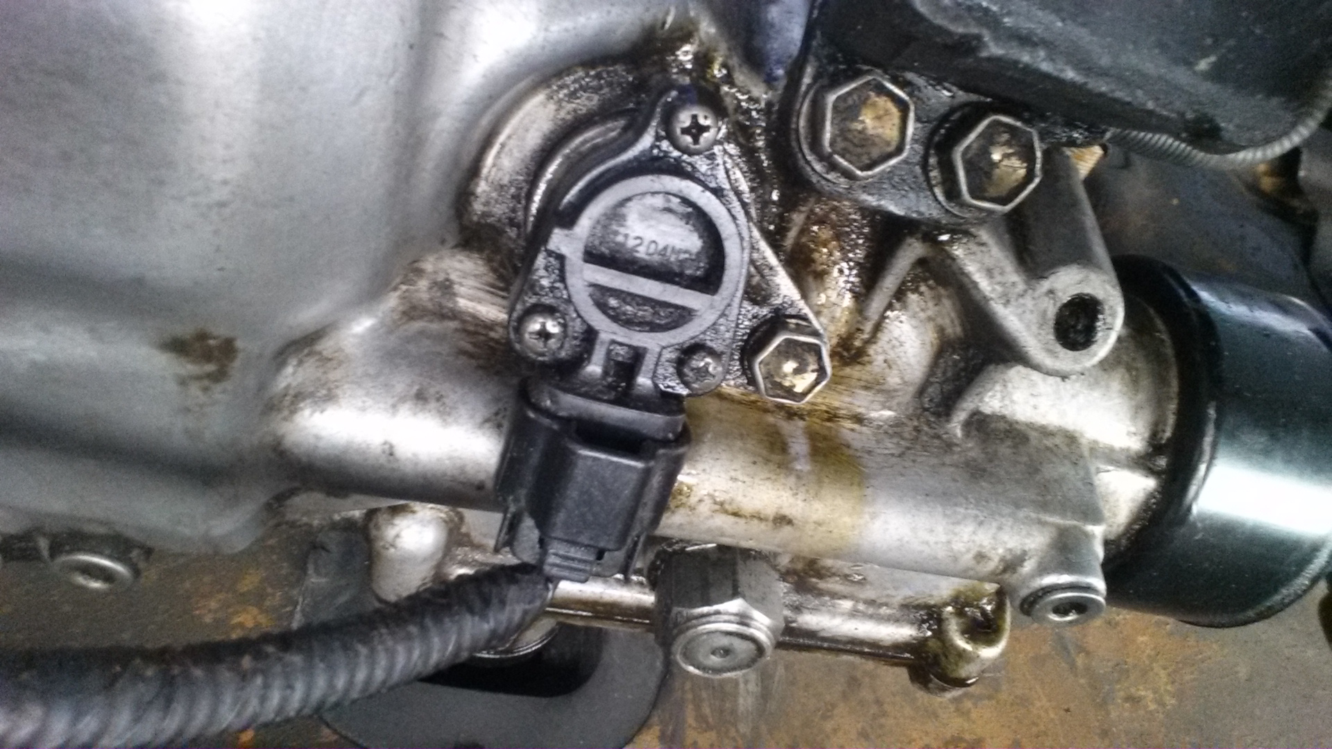

Cleaned it up and topped off. No major leaks at all, must have been all that gunk making it look worse. There is a very small leak coming from what looks like a sensor (I'm guessing the speed sensor) in the last pic previously posted.
Is there some type of gasket that can be replaced here?

Pretty sure it's an O-ring. Don't remove the screws, remove the bolt with the 12mm hex head then twist and pull the sensor out. You'll see the O-ring on the body of the sensor.

Just got a better look...might be that bolt above the sensor (pics upside down). Again I am a noob w/ tranny anatomy

It's still a bit hard to tell where the leak is coming from, all the sealing surfaces still look wet and oily. Try using an aerosol can of carb cleaner or brake parts cleaner to spray all the seams down. If it's wet all the way to the top it might be the shifter base leaking oil.
