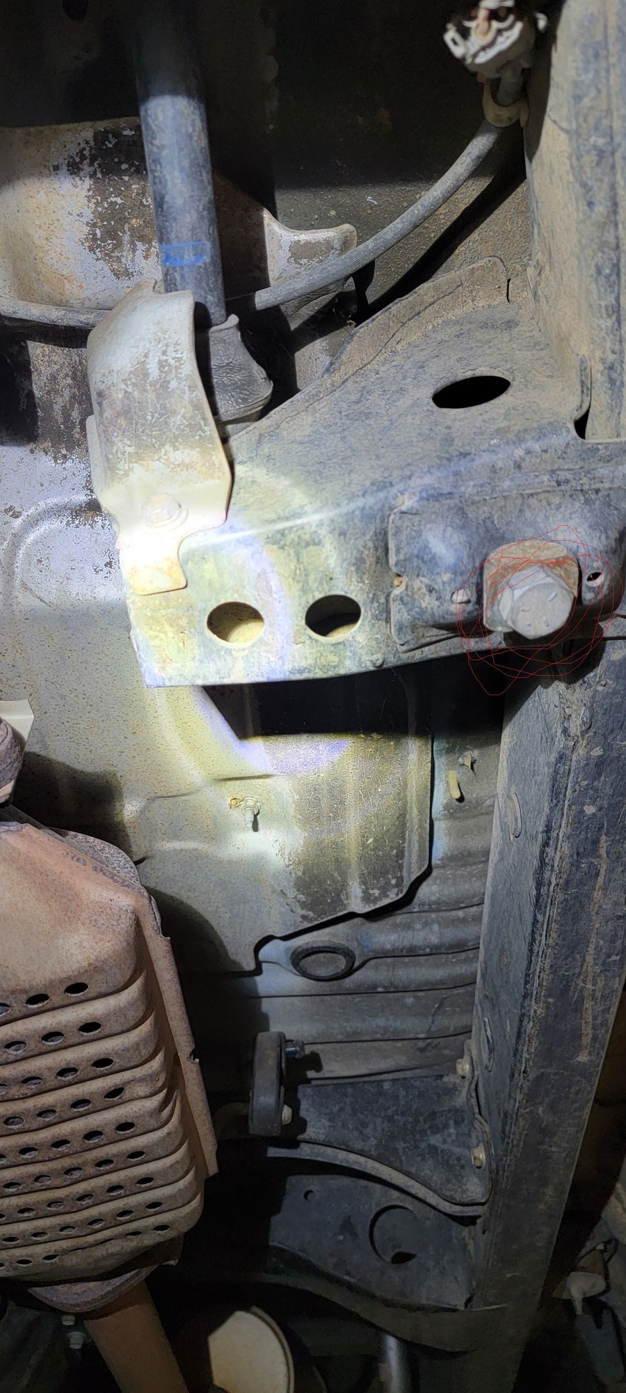

Hey all, can anyone help shed some light on how to remove the upper control arm on the passenger side of a 1994 4Runner A/T 4WD? I've got as many of the bolts as I could find soaking in penetrating fluid at the moment. I have also removed the ball joint connection and shock.
(1) What is the point of the torsion bar? Do I only need to unbolt the 2 bolts attaching the torsion bar the to UCA or are there more components of the torsion bar apparatus I need to take apart?
(2) There are 3 bolts on the top of the UCA. After removing the torsion bar connection and these 3 bolts will the UCA come loose? Or do I need to remove the nuts on the sides that keep the shaft in place?
