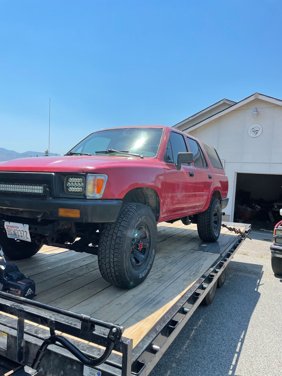

1990 4 runner 3.0 problems.
Just picked this up 2nd gen. Can’t get it to stay running unless I keep on the throttle or move the MAF sensor back and forth. Just replaced the stock fuel filter. Rebuilt motor hasn’t even been broken in yet. Someone tell me how to upload a video and you’ll see what I’m talking about but here is an
imgur link: https://imgur.com/gallery/fnHhkOm
