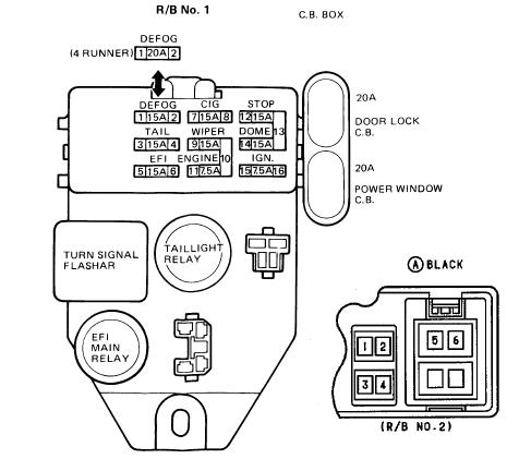

ok just googled the fuse box diagram, and its my efi fuse, the fuse isnt blown but it wont light up, i dunno wtf to do
Old Mar 30, 2013 | 04:56 PM
  #53
Co_94_PU's Avatar
iTrader: (-1)
Joined: Dec 2012
Posts: 5,433
Likes: 555
From: Colorado
Start with the high power fusiblelinks you replaced with jumpers under the hood, AM1 and AM2, and ALT. In the videos I noticed the Alt one was a little weak, plenty big wire but looked like only one-two strands in the crimp connector. I'm assuming these are DIY but anyways.
Got power on both sides of all of these?
EFi fuse in the 80's models in bottom left of the #1 relay block, located in the drivers side kick panel. (Yeah you already know that but someone that shows up here under a search might not)
Verify power at Rb#1 pin 6 and Ignition switch pin #8 White-red wire.
Double check the AFM is pluged in correctly, it'll blow the efi fuse. Then replace the fuse.
Hopefully it'll start right up and you can

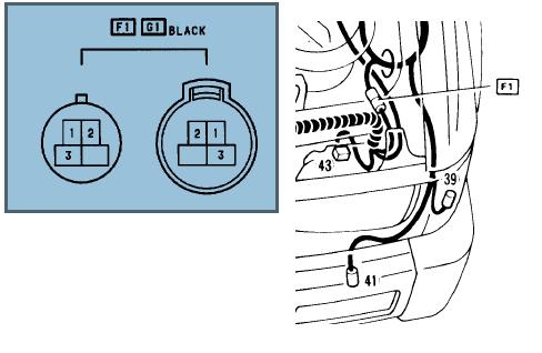

You've got some wiring gremlins for sure.
Verify you have power on pin8 of the ignition switch plug.This rules out a disconnect between Rb #2 and plug F1
Pretty sure you'll have power on the ignition switch. If not next check plug F1 pin 3, If you do unmount the relay block #1 and make sure the spade connectors for the fuse didn't just get shoved into the box.
The questionable wire is White-red, at the Rb#1 pin6, ignition switch pin8, and Rb#2 pin1.
