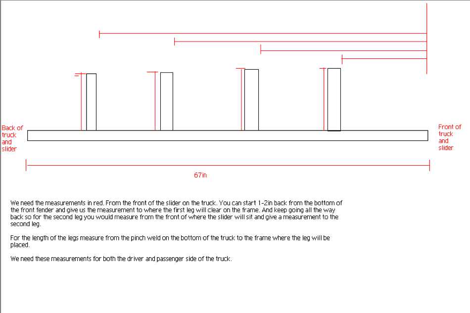

I started paying off a set of Demello rock crusher sliders (all square tube) last February and finally paid it off early July. I've been waiting for them for the past 5 weeks and finally called to see what was going on. It turns out that the set with my name on it was actually for a 3rd gen and they don't have measurements for 2nd gen 4runners anymore. I've been sent this chart that I need to fill in so they can build my sliders. Knowing myself I will make a measurement error and &^%&*% things up, ending up with a set of sliders that look like something out of salvador dali.
so I am posting this here, if anyone knows these measurements for a 2nd gen (are they all the same?)
that would be awesome. I was hoping to have these sliders a while ago, but at least I know why there was a delay. The sliders look so beefy I know it will be worth it once they arrive.
thanks for your help with this chart

thanks Tofer, seems like you had the same problem. When I ordered them back in Feb (paid off in July). I was told that they were on the shelf, ready to go, so when nothing appeared after a lot of weeks. then I find out that they have not been built yet and I have to measure my truck. so I was thinking about just forgetting about the whole thing, but I really like the design of these square sliders they are very strong and a good step. So I think I will try and get these measurements to them. My thing is that I have no idea where the legs will clear the frame, nor the pinch welds etc. It would be cool if they had a 2nd gen to measure or at least records, I am sure they have made sliders for a 2nd gen in the past? crazy. maybe I should email Stubbs
As you may know I have paid for and been waiting on the 2nd gen sliders from Demello Off-Road for quite some time, before being told that they could not start the build without receiving detailed 2nd gen measurements from me. I did not feel qualified to send these measurements and then receive mis-measured expensive sliders. Demello unfortunately had absolutely no way to get these measurements and could not find a 2nd gen.
I therefore contacted Richard Stubbs even though I was not a customer, and he extremely generously went out of his way in an extraordinarily busy week to send me precise measurements and instructions for the 2nd gen slider measurements. I am posting these here for reference, and I would like to send out a wholehearted Yotatech 'kudos' to Richard Stubbs for helping me even though i was not his customer YET, with the emphasis on YET
Here are the measurements! I hope that with these numbers that Demello will be able to take care of my sliders and get them on their way. I have no doubt about the weld quality and design of the Demello sliders, I wish that the communication and commitment to 2nd gens was a little better.
Hello Taiko,
I will try to see if I can help you out here. It is pretty darn basic the measurements BUT the front leg is the "catch" being that it is at a 12 degree angle. This leg in particular will have to be cut slightly long, and the scab plate left off. It will be up to the installer to "fit" the sliders exactly. The main reason for not making it perfect is that the frame can shift (naturally or an accident), and because the fit needs to be perfect it is best to do it this way. The rest of the legs are not a problem, and should be cut to the lengths I am providing you. The scab plates should also be installed at this time as well. If you have any other questions please be sure to ask. Oh, and good luck.
Take care,
Richard Stubbs
Measurements are the same for BOTH sides of the truck.
Overall length 63 inches long
front_____________________________________________ __________________rear
Front leg middle leg rear leg
On center 5.5" 29.5" 47.75"
Middle & Rear Leg length 7.25” inches long (total length including notch cut)
Front legs (cut long remember) 10 ¾” with a 12.5 degree angle cut / long side after angle cut is where you come up with 10 ¾. (total length including notch cut)
You are correct on this particular model we only use three legs however they are made using .188 (3/16) wall chromoly tubing (legs only). DOM can be substituted with reasonable results but it must be .188 wall tubing! Scab plates should be 3x4x1/4” using cold rolled instead of Hot rolled.
That pretty much sums it up. The rest of the slider meaning the outer portion can be made to the same dimensions as a 3rd gen 4runner. It’s really only that front legs that’s a pain.
Hope this helps,
Richard
