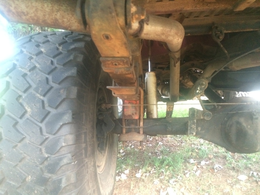

What's wrong with the ole yota? Is it something wrong with my leaf spring? That right back tire drops way lower then the left when jacked up.

Are you in the rust belt? The shackle might be rusted to the point it won't let the suspension drop all the way but it will still compress when you load the truck.

here it is

Take some pics from both sides and closer from the rear to show more detail.
Same shocks on both sides?

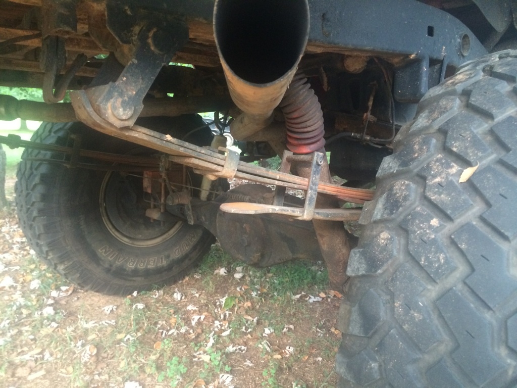

well I always thought it had the same set of shocks on the back cause it has the same on the front two tires and the back left. But now that I look it it the back right doesnt look the same. I no longer have it jacked up but hereit is sitting.

One shock is letting it droop more than the other it would seem. Maybe time for a matching set of rear shocks?
