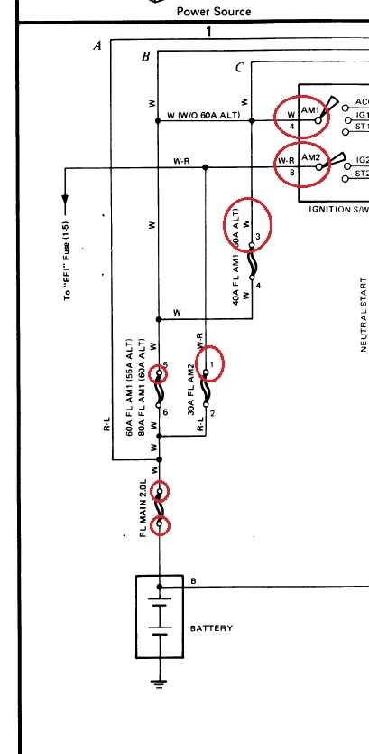

Since no one has shared schematic for you truck, I hope it's similar to 1986-1988 22RE below ...
Please see if wire colors are same and trace wires between fuses up to pins 4 & 8 of ignition switch.
Probe all points encircled in red. They all should have +12Volts. Where you lost 12V, trace that wire/fuse back to where there is 12V. Inspect and test fuses and wiring.

So I finally got some time where i wasnt tired from work to go and try to track down this issue... and apparently i left the key on the on position from the last time i was out there frustrated at my efforts. So when the battery get done charging ill get back at it. also i took a picture of the fuse box and where im touching the wire to start the car.
The black wire I isolated on the left plug there is the one that I directly take a wire and jump from the battery to turn over the car and start it. Found my manuel from when i had my old 89 4runner but it only goes to 88, but it seems to be the same wiring as the pic you posted and is the same as in my book.

So you connected a separate wire from the battery positive to that thick black wire with the white stripe, AND you were able to crank starter AND you got combustion (the VROOM!)?
Sorry but black wire with white stripe does not match anything on the 1986-1988 schematic.
Did you trace exactly where the thick black wire with white stripe runs to?

So I feel dumb, but I was talking with a buddy today about my issue and he works for a shop, he says that he would replace those big fuses in the fuse box, the 30a and 40a. Well I took his advice and sure as ˟˟˟˟ he was right the green 40a had blown but you wouldn't have been able to tell unless you took the fuse apart. So problem solved. Thanks
