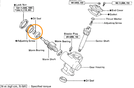

Hi, I just ordered 8749 part number and it fitted, I just put everything back again but now I am having another kind of problem, I have a lot of play in the steering wheel at the point that its funny when I am driving on the highway, I adjusted the top pre load nut on the gear box but the steering gets too hard, what could be missing here?

The Edelmann kit was complete for me. It had to two seals, and a bunch of O-rings and teflon seals too. I only replaced the input seal since that was all that was leaking for me and it's really easy to get to. Can be done with the box in the truck.
I'm trying to get away with just replacing the leaky seal in my steering box. To clarify: the input seal is also referred to the worm shaft seal?
With the box still in truck, you can just take out the lock nut, adjusting screw then somehow pry out and press in a new seal?
