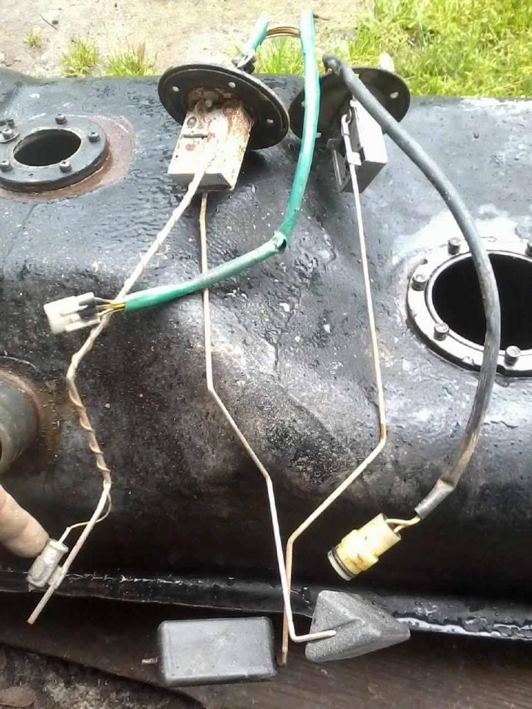

I wonder if it isnt in your speedometer assembly. Is there a crack letting light in from another source or from one of the other bulbs? Is it bright at night when the headlights are on?
I am fairly sure thew Fuel Light is an option. Does the replacement have a 3 wire plug? The ones without the Low Fuel Light is only a 2 wire plug.
Here is the difference. Round plugs are for the 86 and older but you can see the number of wires and the differences of the option on the Sending Unit. The Bulb at the bottom of the unit is what triggers the light. Just because you install the 3 wire unit, it has to be wired in the main harness.

The sensor was purchased new from Toyota based on the VIN.
And, yes, it was the 3-prong with the green outer just has you have shown...matched the one I pulled out.
