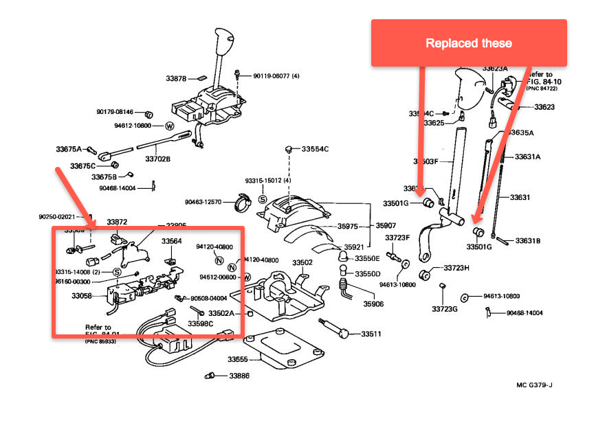

Oops should have clarified. Automatic 2 Wheel Drive.
When in Park, I can not get the button to go in all the way to change the gear.
If I push the button to move the gearshift, I can move around the other gears, the problem is in getting it out of lock when it is in park.
Attaching a pic...
After taking it apart I noticed there's a lever that moves forward and backward which is what allows the manual override to work.
When you push the manual override, it moves the lever forward.
Part 33058 is the solenoid, which I believe is responsible for moving that lever.
https://parts.stevinsontoyotawest.co...305835040.html
I have read that the solenoid does go bad in these, but the timing is suspicious..
No issues before disassembly and now, the issue... Can you ruin a solenoid by bumping it?
I currently moved the lever forward and wedged a toothpick in so it does not release back, which allows me use as normal for the time being, but I would like it to fix correctly,
just trying to figure out what the actual issue is.
