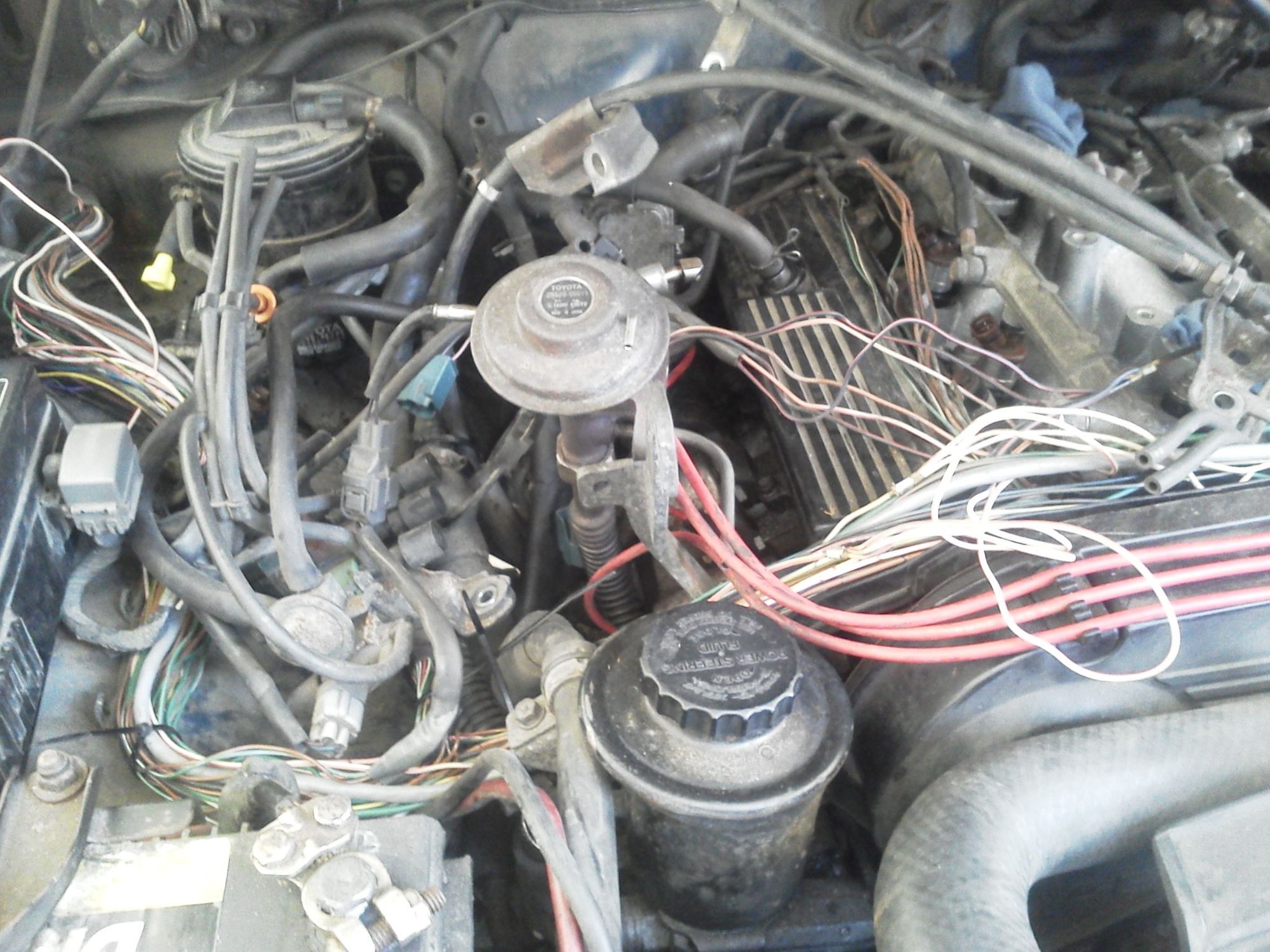

No just thinking of just putting it back together and see what I get , I get some power to the tails opened the wiring harnes up could not see any breaks, the wire here the connectors on the pig tails are a little burnt ( dryed out from heat ) this pic is not that good but I got 9vdc her but not for very long, I still get 12 vdc to the black with the red strip, to ground, cleaned the Graounds that are back by fire wall on engine under fuel rail ,
Old 10-24-2016, 09:44 AM
cryptkeeper's Avatar
Join Date: Sep 2016
Location: Binghamton , NY
Posts: 90
Received 0 Likes on 0 Posts
Here is another pic of harness , in the other pic I posted holding that wire , the other one in the back ground gave me 9vdc to ground I have taped them back up and ready to just put it all back together , don't know if I should buy new pic tails or not ? You can see the black ans red striped wire over to the right with the splice or crimp, the brown groungs you can see going to the back of engine that I cleaned . so thats about it for now.
