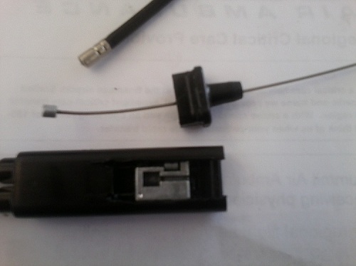

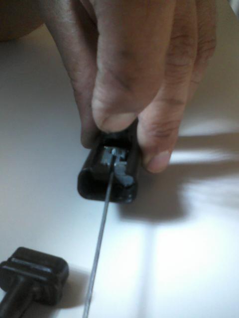

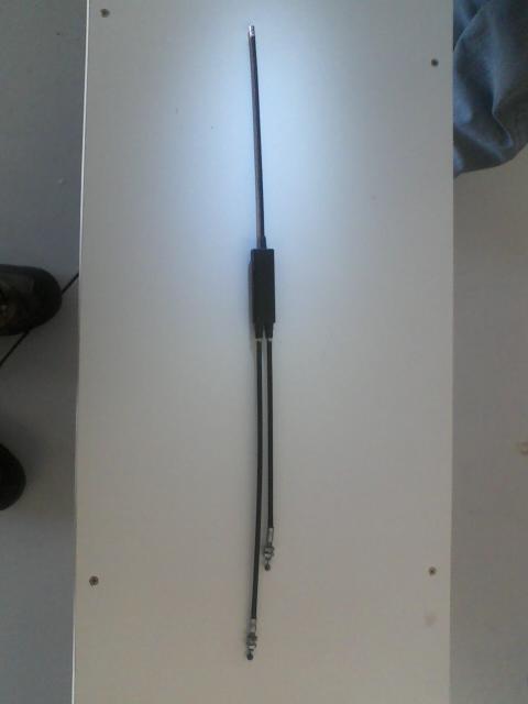

I couldn't see CyMoN's pictures but my fix might be similar. My cable broke where it goes to the backrest, about a inch and a half from the end. The other side of the box has the two cables that were in perfect shape. I popped off the removable end of the box with the ONE cable. Then I cut the box lengthwise with two cuts.(look in the box to make sure you cut the right side-you'll see the slot for the cable) I left enough material so that it has strength when it all goes back together.(In other words the cuts are pretty close together) Cable came out nice and easy by raising the "tab" you just made and the box will work just fine when it goes back together. I'm headed to the bike shop to find the same diameter cable with a close to matching end, but the end doesn't have to be exact-just need to fit in the box and the little metal block. The cable length doesn't matter when buying because I will adjust it with a heavy duty crimp when I get to that point.

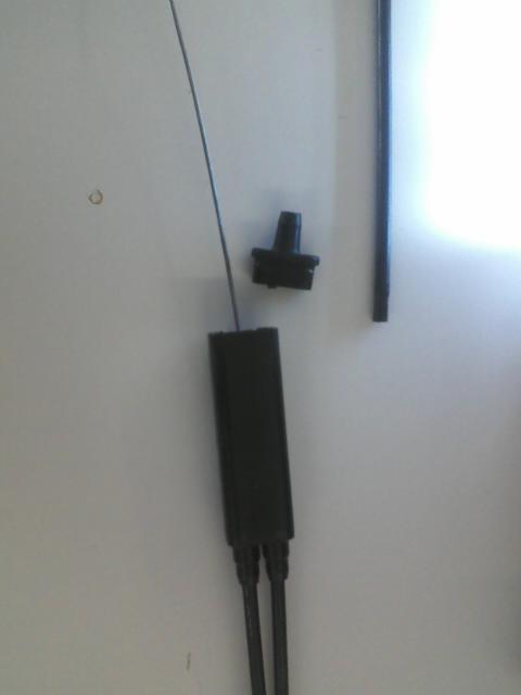

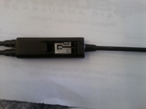

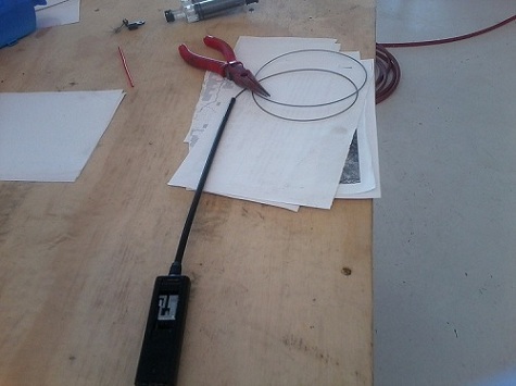

So this post is a follow up to my DIY fix, its for those who like to save money or if you're like me-poor. The bike shop gave me a used cable for free! Pic 1- New cable along-side of old parts(notice my "tab" broke off- I sent a friend to the bike shop this morning and I think the cold weather made the plastic hard-plus he's and idiot) But no matter this will still work. Pic 2-Cable and parts put together.(I put a drop of epoxy in with the new cable to keep it from coming out, an unnecessary step if you don't have a retard break your tab) Pic 3- Look at all that extra cable to work with!!! (that's not much cable for a bike so hence the freeness)
Time- less than 30 minutes
Cost- Free
