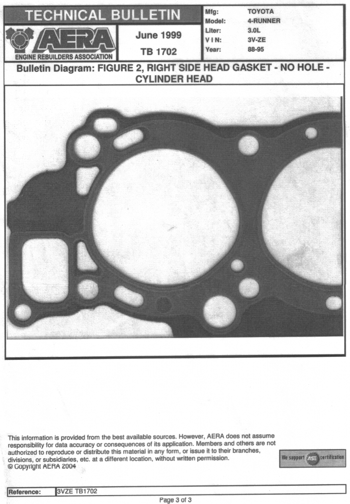

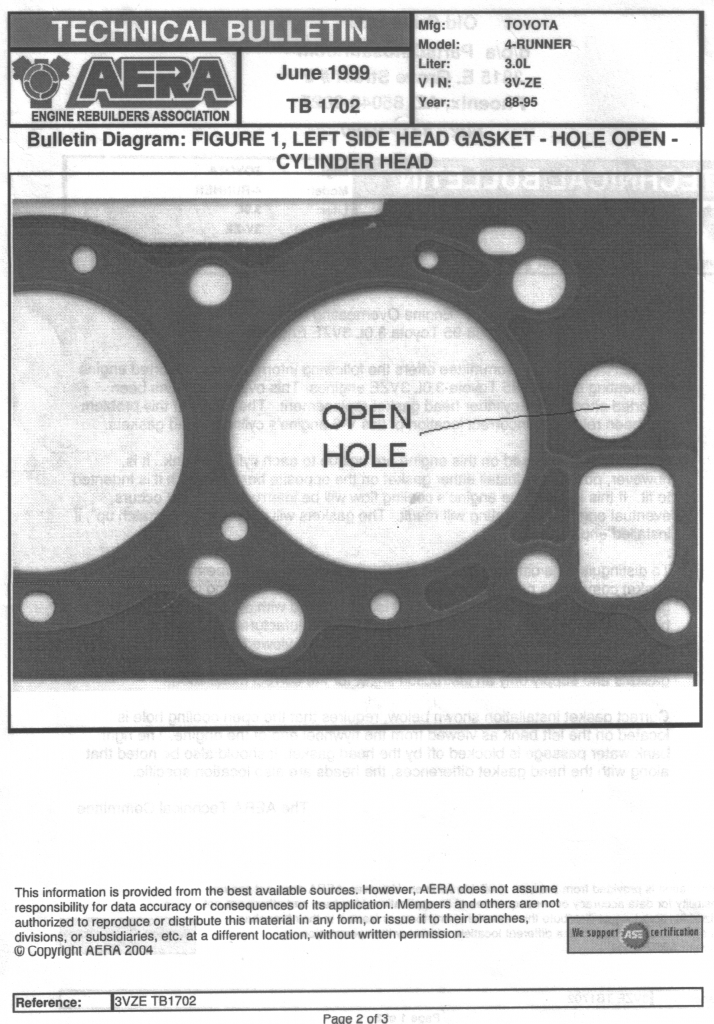

hey everyone im new here, i tried searching for something like this but there was nothing similar to my question. anyways i bought a 1992 4runner 3.0 about 2 years ago and of course my headgasket went out.
so i replaced it all my self and the help of a friend. took heads to machine shop and had them resurfaced and pressure checked. i got everything back on and (btw this was my first time doing this) so anyways i keep hearing mixed answers that the right side of the engine is the drivers side but others say its the passengers. i just based it by looking at the engine.
so my question is i put the right headgasket on the driver side and left headgasket on the passenger side. please tell me that is correct??? i really dont wana go back through all of that work. i feel like an idiot already.

If you are going by the manual, the Right-Hand side refers to the passenger's side of the engine and the Left-Hand side refers to the driver's side, as though you were looking at the engine from the cab.

Sorry to say, but you installed the gaskets on the wrong sides per Toyota FSM.
Passenger = right
Driver = left

It's really hard to say, but safe to assume it'll let go at the least opertune time, like half way across death valley for example. Just repair it now while it is all fresh in your mind and it'll go much faster this second time.
If you sell it like it is undisclosed and w/o a discount, karma will bite you in the butt again at the worst possible time most likely.
Not sure off hand what the gaskets look like fresh, but usualy a head gasket will have a metal side these always go to the block side. And unless you specificly read "while looking at the engine on your right side" the "right side" will always refer to the passenger side.
